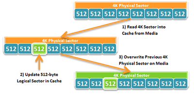

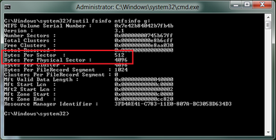

@jmarsh fsutils of XP doesn't show "Bytes Per Physical Sector :" ; likely because the OS always expected 512, so it wasn't mentioned.
87.32 KiB
1791 views
fsutil of later Windows
23.66 KiB
1791 views
read-modify-write
Source: https://docs.microsoft.com/en-us/windows/comp … tibility-update
It also says that XP is not suited for 4kn/512e drives (the latter is false likely and marketing):
"While not stressed in the preceding table, Windows XP, Windows Server 2003, and Windows Server 2003 R2 do not support 512e or 4Kn media. While the system may boot up and be able to operate minimally, there may be unknown scenarios of functionality issues, data loss, or sub-optimal performance. Thus, Microsoft strongly cautions against using 512e media with Windows XP or other products based on the Windows XP codebase (such as Windows Home Server 1.0, Windows Server 2003, Windows Server 2003 R2, Windows XP 64-bit Edition, Windows XP Embedded, Windows Small Business Server 2003, and Windows Small Business Server 2003 R2)."
My last words on FAT32.. In comparison to NTFS, it is inconsistent. Some parts of it can get shifted or are larger/smaller, resulting in an aligment in which some of the 8x512Byte Sectors don't perfectly overlap with the drives 4K sectors anymore - even though the FAT32 partition itself starts at at the correct spot.
As for LBA. Yes, it is an arbitrary thing. Though it is also contiguous. Sector 64 starts after 63 etc.

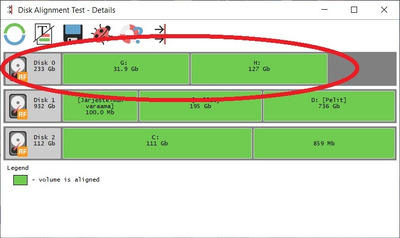

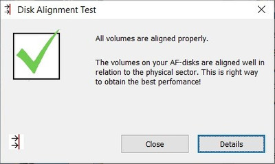

Reply 51 of 91, by khyypio
EDIT: Didn´t work, don´t try this 😁
Oh boy, so many opinions it´s making me dizzy... 😁 Anyways, I found a tool called MiniTool Partition Wizard, so I plugged the SSD to my Windows 10 PC and used the previously mentioned tool for partitioning, aligning and formatting. Could you guys take a look if I did this (or any of it) right?
In MiniTool Partition Wizard I created two partitions to my Samsung 860 EVO, a 32 Gb for OS (C) and 127 Gb for games (D). I made them both Primary, file system FAT32 and cluster size 4KB. I also set the Partition Align to "Cylinder" of the 32 Gb partition.
189.07 KiB
1771 views
Then set "Align" to both partitions and at this point I clicked "Apply"
184.39 KiB
1771 views
After aligning I set "Format" for both partitions (FAT32 and 4 KB)
128.82 KiB
1771 views
When formatting was done, I ran the Disk Alignment Test and everything seems to be okay...
20.37 KiB
1771 views
52.54 KiB
1771 views
What do guys think, is this SSD ready for some Windows 98 hardcore action?
Reply 52 of 91, by jmarsh
Jo22 wrote on 2020-10-21, 15:40:
Your picture shows 2 things:
1. That's a 512e drive, not 4KB native.
2. That's either not XP or for some strange reason you're using a Vista theme.
Anyway, I'm done. Instead of relying rumours and Wikipedia (which are basically the same thing) my posts are based on first-hand experience: Windows has been able to use native 4KB drives since at least XP.

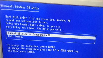

Reply 53 of 91, by khyypio
khyypio wrote on 2020-10-21, 20:24:
Oh boy, so many opinions it´s making me dizzy... :D Anyways, I found a tool called MiniTool Partition Wizard, so I plugged the S […]
So this didn´t work, when I boot via Windows 98 installation CD, it can´t even find C. Then I made only the partitioning and aligning in MiniTools, also activited the C-partition in it, then I did the formatting in older EaseUS (FAT32, 4KB). Then I could go to C but I couldn´t copy anything in there (Abort, Retry, Fail). After that I just tried to ran the installation straight from the CD and I got this:
1.73 MiB
1735 views
If I let it format, it messes up the 4KB alignment. What am I suppose to do here? 🙁
Something is indeed not right . If you can't even access a FAT32 formatted partition under Windows' included DOS , there is no point in trying to install Windows onto it .
I may be mistaken, but just formatting an existing partition should not change its offset and, consequently, its alignment . Many programs tend to combine partition creation and filesystem creation, but, AFAIK, it is at partition creation that the calculation for proper offset and hence alignment is done . If you want to test that, just re-format on your retro machine (without re-partitioning) and re-test alignment on your modern PC .
Either way, as a test, you could forget about alignment for now and just try to format and install, just to see if there is not another issue at play here . If you do get past that hurdle, remember that at first boot Windows will try to access the disk using ESDI_506.PDR which does not handle >127GB drive sizes, so you must patch or replace ESDI_506.PDR before that first boot . Read the info provided with BHDD31.ZIP for more detailed instructions .

Something is indeed not right . If you can't even access a FAT32 formatted partition under Windows' included DOS , there is no p […]
khyypio wrote on 2020-10-22, 16:01:
So this didn´t work, when I boot via Windows 98 installation CD, it can´t even find C. Then I made only the partitioning and ali […]
I suppose that´s one possiblity. You have a very similar system as I do, right? How did you get it up an running?
Reply 57 of 91, by darry
khyypio wrote on 2020-10-22, 16:29:
darry wrote on 2020-10-22, 16:19:
Having thought about it, if on a modern system, you formatted a filesystem bigger than 32GB with a forced cluster size of 4K rather than the 32K that it should default to, that is likely the reason Windows 98 SE and its DOS are choking on it as using a cluster size too small on a big file FAT32 filesystem will result in too many cluster for Windows 98 SE (and its DOS) to handle .
EDIT : See https://docs.microsoft.com/en-us/previo ... dfrom=MSDN
With a 4K cluster size and a maximum of 4,177,918 of cluster , you can create a FAT32 filesystem about 16GB (a bit less actually) in size . Creating anything bigger with 4K clusters will be out of spec and Windows 98 SE (and its DOS) will not like it . If you want to create a bigger FAT32 filesystem, you must use a cluster size bigger than 4K . The biggest that Windows 98 Se will allow is 127GB with a 32K cluster size .
It has been a while (I last installed something like 4-5 years ago), but I think I was using a SIL3114 (or possibly a SIL3512) SATA controller at the time and I created my partitions in Linux (or maybe Freedos FDISK, which I do not recommend), formatted them in Windows 98SE's DOS and installed Windows . Even though it was not absolutely necessary at the time (SIL3114/SIL3512 do not use ESDI_506.PDR, so Windows was using BIOS compatibility mode until I install the SIL drivers), I still installed BHDD31.ZIP for the included utilities. I eventually switched to the onboard ICH2 controller and since BHDD31 was already installed, I did not need to do anything special .
My recommendation is to
a) partition with whatever modern alignment aware tool you like on a modern PC .
b) format as FAT32 on the destination retro PC (or on a modern PC with a 32K cluster size) and make sure everything is readable and writable .
c) Optionally, confirm on the modern PC that alignment is still OK (it should be)
d) Install Windows 98SE following the instructions provided with BHDD31.ZIP
If step b) fails, something is wrong either on you retro setup or the partition tools you used to create your partitions .

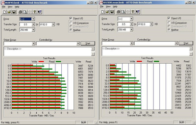

So I did what you said, it didn´t pan out 🙁 Then I just simply did the partitioning and formatting with Super FDisk 1.0 and everything is running smoothly (and yes, I replaced ESDI_506.PDR as instructed). All the drivers are installed, no games though. Snappy boot-up and everything seems to work smoothly. BUT then I ran HDD benchmarks and take a look:
148.71 KiB
1681 views
SSD on the left, SD on right. SSDs rates are terrible compared to SD! If this is the best I can get, then it´s better just to get 120 Gb SD card.
Another weird thing: swithing DMA mode on from Device Manager turns performance to shit so boot-ups takes like 2 minutes and desktop use is horrbily choppy.
