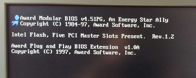

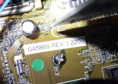

Hi,
I've got here a fine Retro-PC (sig #2) with a GA-586S , Rev. 1 .22C Mainboard with this Bios**.
To use the most performant CPU* it obviously requires a Bios upgrade (to 1.04) but I can't find any source for it 🙁
Or does the current Bios already exeed this requirements?!?
(I'am sometimes not shure about Bios- and Board-versions)
Help would be appreciated ...

Reply 1 of 9, by Deksor
There you go 😀 http://www.elhvb.com/mobokive/Archive/Gigabyt … 586s/index.html
Reply 2 of 9, by ildonaldo
Many Thanks.
With the help of your link I've had been able to confirm that the board runs already with the latest bios 1.20.
