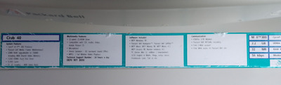

Help needed for a new Packard Bell Club 30 / 40 owner.
Hi all, I know this is an old topic, but does @Richy85 (if still active), or anyone else know if he made these Master CDs available as ISOs anywhere? If so I'd be extremely grateful if someone can help me obtain them, or point me in the right direction please.
I've recently bought / restored a Packard Bell Club 40 (PB850/FR500 Hercules) system, which AFAIK, aside from including a Modem is identical to the Packard Bell Club 30. Like @Richy85, I'd love to install the original software/OS setup, to get the full PB experience.
Thanks to his YouTube video, this topic & Passion-PB, I've been able to restore the HS / BIOS Tattoo, but need the correct Master CDs, and they're not on Archive.org.
This is the highlights sticker (I guess this was as much a benefit to the sales staff to give them prompts, as much as it was in highlighting the value to consumers) which lists the main specifications & software bundle, which in the the installation process on these Club machines I believe I've read on here somewhere is referred to as the 98 Club College software bundle?
Packard Bell Club 40 Case Sticker
