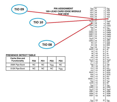

The additional I/O lines TIO8-TIO10 are not present at the early versions of the COAST slot - there´s only TIO0-TIO7 (at pins 2,3,4,5,82,83,84,85)
If you insert a COAST module with only one TAG-Chip into these slots it will be working together ("parallel") with the onboard TAG-Chip WITHOUT enlarging the TAG-bus width to 11 bit.
download/file.php?id=82702&mode=view
In cases like this the onboard TAG-RAM besides the COAST-Slot will / must be connected to TIO0 - TIO7. When there´s 512K onboard cache present, or a COAST module with additional 256K and just one TAG RAM on the stick, the TAG-RAM in the DIL socket will take care of TIO8-TIO10.
The later COAST versios (3.0 and above) have been modified and connectors for TIO8, TIO9 and TIO10 have been provided at three contacts that have been "NC" before:
101.31 KiB
435 views
If there´s only one TAG-Chip/socket onboard and you add a COAST module, the module MUST be a version with two TAG-Chips - one on the front besides the L2 SRAMs and one on the backside. The chip on the backside is wired to COAST -socket pins 6, 86 and 88 for TAG-bus I/O lines TIO 08 - TIO 10. Then and only then you get the broader 11 bit TAG-bus width and accomplish the full L2 cacheable area of 512MB of RAM.

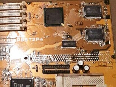

But look at this example of an ASUS P/I-P55T2P4 (a late revision 3.xy):
40.19 KiB
450 views
The COAST slot is not present, so I assume the onboard L2 cache is 512K. Then there´s one TAG-RAM onboard that allows a maximum cachable area of only 64MB
To expand the cacheable area to 512MB you had to populate the DIL socket with a second TAG RAM.
I don´t think a TAG-RAM (16Kx8) was THAT expensive back then. Either it has been removed by a former owner or ASUS didn´t populate it to save some money.

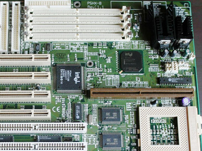

Today I did some further research and some tests with an Elitegroup "P5HX-B" (Rev. 1.1 with split voltage):
298.46 KiB
434 views
There´s 256K L2 cache onboard plus a 32Kx8 TAG-RAM and there´s a COAST slot.

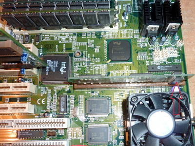

I updated to BIOS 1.6h (the latest one that I know), jumpered everything carefully and inserted 512MB FPM RAM and a regular 256K COAST stick.
At POST a total L2 cache of 512K is detected correctly. Then I turned "cacheable area 512MB" on in BIOS setup and started the system.
No surprise that I was stuck at a cacheable area of 64 MB no matter what I tried, because there´s only one TAG-chip onboard and a second on the COAST module - both of them wired to TIO 0 - TIO 07 as we know now.
With an ASUS COAST 3.0 module with 2 TAG-Chips everything´s working perfectly.
