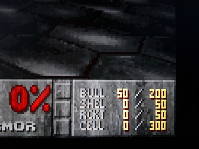

A photo of a corner of an OSSC line-doubled 640x400 form Voodoo 3 VGA to 1280x800 image on a Philips 252B9 that scales it to 1600x1200 .
1.79 MiB
1447 views

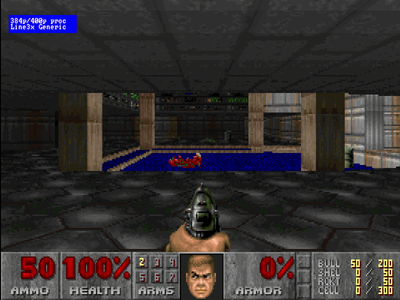

A video capture of the output of OSSC digitizing 640x400 form Voodoo 3 VGA as 1600x400 and applying line3x on the y axis . There are artifacts as this drives the OSSC at 189MHz, which is out of spec (has aforementioned artifacts on my OSSC and others).
1.15 MiB
1447 views
EDIT: If the second option shown worked on my OSSC, it would essentially be the "Holy Grail", in terms of displaying 320x200 on a modern display, IMHO . Hopefully OSSC Pro will be able to do that .

Looks pixel perfect to me! Excellent 😀
BTW does this IPS panel have ghosting? It commonly manifests as a luminous patch in the bottom right corner that shifts as you move. To see it display a black image and look at the monitor in a completely dark room.
darry wrote on 2020-09-09, 00:57:
EDIT2: @cde When you asked about the FX5500, did you mean over VGA or DVI ?
Well I was just wondering if the VGA output from the FX 5900 XT was as sharp/bright as the 5200 and 5500.
Thank you for specifying . I will test my FX 5500's VGA output at 1280x800 when I get the chance .
I will also check for IPS ghosting when it gets dark here . On a semi-related note, I can say that backlight uniformity is good enough for me not to have noticed anything amiss . The Dell U2412M that I bought and returned due to a scratch had terrible backlight uniformity that was very noticeable even under normal lighting conditions and the research I did at the time, the monitor was likely within allowed tolerances on that front (very loose tolerances, IMHO).
