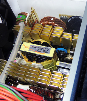

RIP:
Enermax EG495AX-VE(W)
Manufactured March 30, 2005
3.3V and 5V @ 32 A
New Old Stock (NOS)
I paid a pretty penny for it, and it was only used for 12 hours. I heard a loud bang during a Read/Write repair of a 1997 HDD in HDAT2.
I need to see if it took the Abit LX6 and Quantum Fireball ST with it. I have duplicates of the Diamond Viper 330 (Riva128), Pentium II (Klamath), RAM, IDE CD-ROM and IDE floppy, so I'm less concerned about those. Thank goodness I didn't have my Canopus Pure3D and AWE64 Gold plugged into this thing, like I was supposed to.

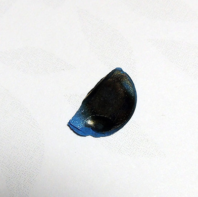

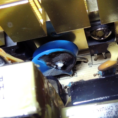

The toast component is a through-hole ceramic "disc capacitor," right? What does this part usually do in a PSU where it is positioned?
PS- Yes, the noise made me jump out of my seat. It was definitely more of a 'bang' than a 'pop.'
Reply 1 of 5, by mkarcher
piatd wrote on 2020-09-27, 21:17:
I have some knowledge and experience with power supplies, and if I am correct, that capacitor is part of the snubber network in the primary side. The job of the snubber network is to catch voltage spikes that inevitably occur at the high frequency transformer, so these spikes don't go so high to destroy some transistors on the primary side. If they fail, the primary circuit might be toast, but it is highly unlikely that this causes overvoltage at the output.

Reply 4 of 5, by piatd
mkarcher wrote on 2020-09-27, 21:35:
All of my other parts appear to be working, so you may be correct.
