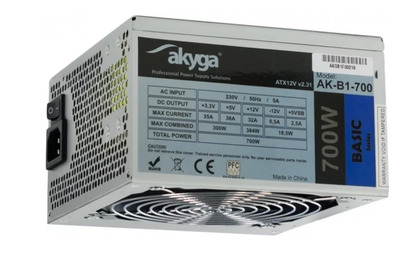

Reply 23 of 36, by OMORES
Usually cheap PSUs claim to have high amperage on 3.3 and 5V rails so numbers can add up to a 600-700W total.
Take a look at this one... 35A + 38A...
