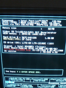

My best guess is that with it set to 66mhz, the best I can do is x2.5 no matter what I set it to, as it maxes out at 166. Still a bump up from 120, but sadly not as fast as I'd hoped. Ah well, I suppose I can live with it.

Are you just looking at what the POST screen says? If so, my guess is that the BIOS just isn't reporting it properly.
Use SPEEDSYS or CPUCHK to verify the speed the CPU is running at.

Via SPEEDSYS with jumpers 13-14 empty for 1.5x speed:

Not having any access to any of these things, I put back the original Pentium-S. Only difference is since I set it to 66mhz instead of 60, at 2x I now have 133mhz instead of 120. So I coaxed a tiny bit more speed out of it. Woo.
