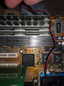

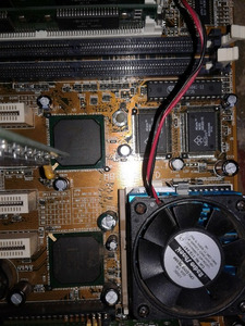

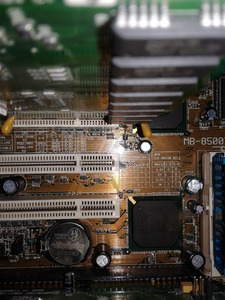

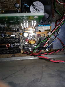

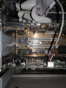

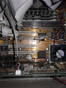

Reply 31 of 54, by tomexplodes
pentiumspeed wrote on 2020-11-04, 00:07:
Please post pictures of the motherboard?
Cheers,
1.) Windows 98SE with Unofficial SP3, AMD Athlon 1.3ghz, 768mb RAM, Geforce 4 MX 440 64mb AGP, Sound Blaster Live! Value
2.) MS-DOS 6.22, Pentium 90mhz, 16mb RAM, S3 Trio64, Sound Blaster Pro 2.0
Reply 32 of 54, by tomexplodes
aaand here. I did the best I could with my crappy phone camera and also not really wanting to disassemble the whole thing at the moment. If you need me to do that, I guess I could.

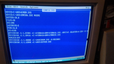

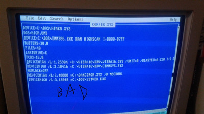

Reply 34 of 54, by tomexplodes
My computer hates my current AUTOEXEC.BAT and CONFIG.SYS. I went back to an older one from my old IDE hard drive and now things work. WHAT THE HELL. I will post pictures of the "bad" ones and the "good" ones shortly.
EDIT: all that's missing from the config.sys in both is D:1 H:5
I marked the bad ones in paint.
