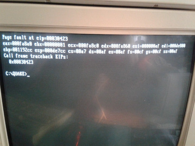

Reply 40 of 54, by cyclone3d
Common denominator is the PSU. Try a different known good PSU.

Reply 41 of 54, by tomexplodes
SodaSuccubus wrote on 2020-11-04, 17:18:
Regarding testing:
Try running a test program like GoldMemory or Memtest. Try with L2 cache disabled first to isolate the ram, and then with it on afterwards.
Thatl root out any ram induced problems. Bad cache in particular can manifest as verious anomalies.
I did passes with and without cache, RAM is fine.
I swapped in the p90 I had, everything seems to be working fine except NFSSE, but I'm pretty sure it just hates EMS. I'll try the PMMX233 again tomorrow when my new thermal paste arrives and if it still doesn't work, I'll contact the ebay seller and tell him it appears to be faulty.
EDIT: Nevermind, even without EMS Need for Speed still won't boot and locks up the whole machine.

Reply 42 of 54, by tomexplodes
cyclone3d wrote on 2020-11-04, 17:50:
Don't have another AT PSU that works at the moment.

Reply 43 of 54, by cyclone3d
What about an ATX PSU with an AT adapter? I don't really trust most AT PSUs anymore.

Reply 46 of 54, by kaputnik
rmay635703 wrote on 2020-11-03, 14:58:
Not all OLD boards actually use multipliers the same way. […]
Cyberdyne wrote on 2020-11-03, 09:43:
233MMX is a special case cpu, it reuses 1,5x speed as 3,5x in capable motherboards. But i have never heard that 1,5x speed will in turn change to 2,0x speed. This is new.
At one point in time board manufacturers could float or ground a multiplier pin (their choice) later on this wasn’t acceptable.
That is why many boards from the socket 5 era with the 2nd multiplier pin may not behave how you want.
Yes, that's almost without a doubt the issue here. A P55 CPU without internal 3.3V connection, and thus floating BF0, in an older mobo jumpered for 1.5x, will run at 2x. It can be kind of verified by jumpering for 3x multiplier, the CPU should end up running at 2.5x.
Here's an article describing the issue in detail better than I could ever do in a foreign language.
In short, the solution is to find 3.3V somewhere on the mobo and use that to pull BF0 high. A simple way to do that is to remove the CPU, put a piece of wire in one of the holes connected to the VCC3 plane, and start continuity testing to different unused headers/points on the mobo. If you find a header pin connected to the VCC3 plane, you can get away without any soldering on the mobo. Patch a suitable resistor in a dupont jumper wire or similar, use it to connect the CPU side of the BF0 header to the VCC3 pin, and you're good to go.

Reply 48 of 54, by tomexplodes
kaputnik wrote on 2020-11-05, 08:56:
Yup, that was the issue. I've since switched motherboards.

Reply 51 of 54, by tomexplodes
Well, I believe I've ruled out the power supply. Got my cable today, everything's plugged in and working, NFSSE still won't load even the installer, Quake crashed nearly immediately. Just for fun, here's a picture of the page fault from Quake, in case someone knows how to decipher it. I think, though, I can probably assume that this CPU just isn't good. I'll swap back to my P90 and just have a much less powerful DOS machine, and just play the more intensive DOS games on my 98SE machine instead. Thank you everyone for helping me, I really appreciate it. Everyone here is just excellent all the time, in spite of my constant need for assistance, and it's just fantastic. Thank you all so much, in general, and for this specifically.
EDIT: so here's another weird thing. Doesn't fix anything, it's just weird; if I disable EMS through memmaker, Quake runs for a few seconds before crashing. I don't understand it.

Reply 52 of 54, by tomexplodes
Yet another post. After more screwing around, I think Quake and NFSSE think I don't have enough XMS. It's possible there's nothing wrong with my CPU at all. I'm confused, though, since I have 32MB RAM and ehhhhhhhhhh I dunno what I'm doing wrong anymore.
