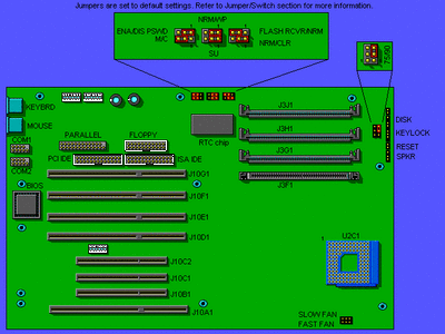

So I picked up a decent looking XPS P90 from a recycler I buy stuff from semi-regularly for $20. Mostly got it for the Teac 3.5/5.25 combo drive but it turns out it was a decent configuration at one point - CT1740 SB 16, Number Nine GXE64 Pro, 128MB of RAM. Unfortunately, before it got to the recycler someone completely cut and removed all of the power supply wires (except for the main power button cord), as well as the wires to the front panel lights.
One of my friends is helping me rewire the power supply but because all of the connectors are gone, I was hoping somebody on the boards had a similar system that they could take pictures of the inside. Particularly looking for the wire colors/pinouts for the three motherboard power connections. I figure there are differences from standard AT on this board.

Ok great ! I have many of the old Dell pages from archive org indexed. Hopefully this matches your board.
Unfortunately there are no good pictures of the inside of the front panel....
Here is one main page: http://web.archive.org/web/19961222115021/htt … PMT/default.htm
The board layout: http://web.archive.org/web/19961231003117/htt … MT/00000004.htm
added: According to this: http://web.archive.org/web/19970605232119/htt … sp/flshbios.htm
this is the last BIOS for it: https://www.dell.com/support/home/en-us/drive … driverid=r18651

I've actually got this system here in my possession now (cut leads and all) and I've got some more info to add:
Big surprise, it's an Intel reference board. Intel Premiere (Plato) to be exact. This means I was able to dig up the manual for the board and get proper pinouts needed for the power supply connectors. I'll attach the board's manual to this post. Back in the 90s Dell was a big abuser of rebadging off the shelf hardware, both desktops and laptops, albeit with different power connections now and then (notice Intel boards have two power connector options? Yeah).
