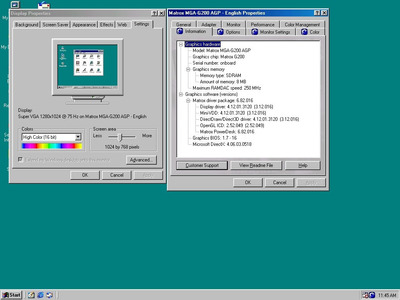

Pity; I'll stick my board (linked below) on the test bench and try a similar base install for comparison - assume your config is still (roughly) as op?

Reply 19 of 23, by PC Hoarder Patrol
TonyStark wrote on 2022-02-10, 18:33:
That's the board alright. And the configuration is still the same as op.
Wasn't able to replicate your problem on the bench...
- clean install of 98SE (board + P3 600MHz + 128MB PC133 SDRAM / PnP OS set to yes in BIOS) on bare 20GB WD200 IDE drive + ATAPI CD drive
- added Intel chipset drivers v3.20.1008 (fresh download from PhilsComputer Lab)
- added Matrox drivers v6.82.016 (fresh download of w9x_682.zip from Matrox)
- no color issues, corruptions, black screens or lockups / freezes
- changed screen resolution, color depth, refresh rate - still nothing
- changed acceleration levels and window drag behaviour (whole window or just empty frame) - still nothing
- was going to try the last version HP supplied (v5.41.008) but didn't seem much point as you hadn't tried them either afaik
Maybe looking like some issue with the actual G200 chip or onboard SDRAM which the 98SE drivers hit but the W2k ones don't???
Screen grab from my install
