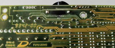

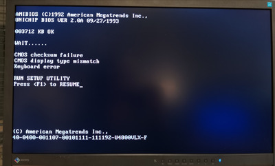

I have problem with motherboard Unichip 386WB. I tried to test this motherboard by booting to the BIOS, but if I turn the computer ON, leds blink on the keyboard and then I get theese messages.
CMOS checksum failure
CMOS display type mismatch
Keyboard error
Any idea what is wrong? Because of keyboard error I cannot go to the BIOS menu. 😕
Pictures are attached.

Could the errors be fixed by replacing the missing battery?
Reply 3 of 10, by konc
I have the same with a really tiny amount of battery leak and it needed a trace repair with the exact same symptom. So yes pay attention to the area around the battery, bottom side included.

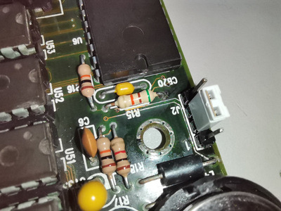

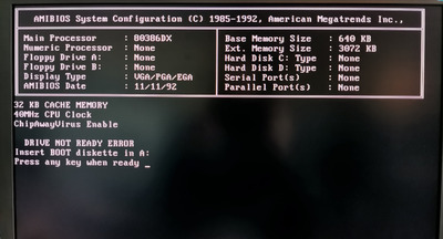

Hi,
many thanks for your help. I check again all way repaired before and found one problem around choke L4. I repaired it. Now it is working 😀 Im really happy 😀
Photo is attached.

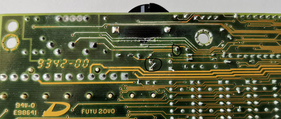

I can see a solder trail shorting two leads of transistor exactly besides the battery holder.

pentiumspeed wrote on 2020-11-18, 20:06:
Cheers,
Hi, thanks for your replay. Can you mark it on the photo?
Thanks, David
Reply 9 of 10, by debs3759
I can see two potential shorts
