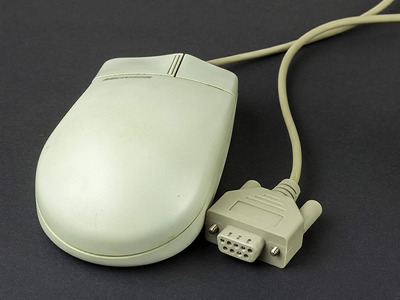

I have 2x socket 7 motherboards, in 2x separate cases. But I can't get my plain Microsoft Serial mouse to work with any of the onboard COM headers.
I've tested the mouse on another computer, it works fine. I've check to make sure I have Pin 1 mapped correctly as well. Reset the BIOS to defaults and checked the settings to make sure there isn't any conflicts.

Well it's one of the attached,
I can grab another mouse at some point and try. And yes I've tried CTmouse but no luck sadly.

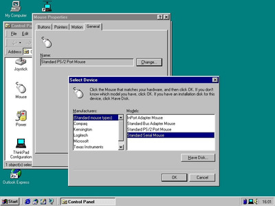

So just updating this one. I found something interesting.
I tested the mouse with one of my ThinkPad's knowing that I would have the same problem. There must be a way to make these things work.
I did a manual hardware detection, just like before.
It detected A serial mouse device, but show's it's not connected. Via the Device Manager screenshot.
After going into the control panel, and manually selecting a Serial Mouse device. I could reboot and use this within Windows.
I'm wondering if this has something to do with PS2 support on such desktops and laptops.
I will try the same method again and see how that affects it. I'm wondering if I can make this work in DOS as well.

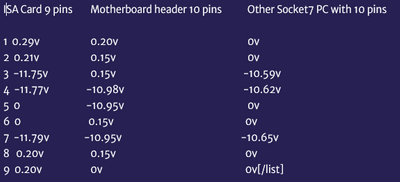

Okay after some digging and getting my BIOS chip re flashed because I broke it.
Thanks to horstmueller for some clues, I think I have narrowed this down.
I'm documenting my findings in-case others come across this issue.
I found an old ISA card with IDE controllers etc. And used it on this same desktop to test with. Straight away the mouse was detected.
My PCI Serial card did not work, this is a much newer PCI card.
So the Pin Outs read the following voltages (see image).
Compare this to my Motherboard header, using the same cable.
The ISA Card as 9 pins, where as my motherboard header has 10. Also my other desktop has 10 pins as well, but the serial mouse works.
Pins 3 & 5 on my mainboard are different. I can only assume this is due to the standards used and what my mouse may support.
I will try and find a dedicated DB9 ISA card, or see if I can get the PS2 header working, as this currently isn't due to a pin type issue.
If I get any updates, I will share them.
Cheers guys!
    17 KiB
    460 views

lackofpatience wrote on 2020-12-20, 02:53:
Project is wrapped up on this one. Thank you everyone for your help.
So, did you come to a particular conclusion? Was it just a matter of having the voltage on pin 3 instead of pin 5?
Reply 13 of 13, by lackofpatience
Jorpho wrote on 2020-12-20, 05:20:
Sadly I never got a chance to test the theory, as I found my PS2 header was wired wrong. So I never got a chance to make an adapter to test it
