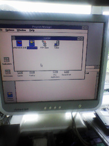

There was an update to half a dozen or so core system files in win3.1 binging it to Win3.11. Packaging wasn't changed though. And to those that don't know this is NOT MS Windows for Workgroups 3.11. That's a different product for use with 386 and above cpus and "Enhanced Mode" was removed.. A lot of built in programs are 16 bit though like the TELNET and FTP clients. I use them on my 286/12 MS Windows 3.1 installation. I get pissed off when a Vogons member say they have an issue with MS Windows 3.11 but it in fact MS Windows for Workgroups 3.11. Rant over. Carry on....

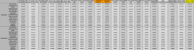

I have been working on and off for the past few weeks compiling extensive benchmark data (Winbench 3.11, WinTach 1.2, WindSock 3.30, WUBench, WinTune 2.0 - Speedy and ByteWB also work on a 286, but Speedy is too CPU-constrained with its benchmark of opening eight windows simultaneously and ByteWB is completely redundant) with my Protech PM286 with a Harris 25Mhz clocked at 24Mhz, i287XL running at 27Mhz, 16MB of 50ns RAM and my ISA SVGA video card collection running at a bus speed of 8Mhz on all supported 256-colour and high-colour modes along with generic 640x480x16 VGA and I should be a few weeks away from posting the full data. This post from elianda was extremely insightful and definitely helped with finding interesting performance curves across some of the video cards I have tested that I would have never seen if I stuck to 640x480x256.
There's a few things holding me back from dropping the full data now - I have a batch of cards coming from the US that should be here by the end of this week including one that I'm 99% certain will work, and more importantly my initial testing of finding 286-compatible drivers started from the latest drivers I could find and going back until I found one that worked, and in the interest of archiving I want to verify that all drivers that I have found work properly rather than throwing it over the fence for someone else to try - for an extreme example, I've found eleven generic ET4000AX drivers including two that were released during Windows 3.1 betas, (a third from October 1991 is known to exist due to it being mentioned in the readme from the December 1991 drivers, but I haven't located it yet) and have only tested the December 1994 and March 1993 drivers as those were listed on the DOS Days website, and being one of the earliest cards I tested I decided to be cautious and start with the earlier drivers. A simple run of Winbench should be sufficient for verification, since it also includes a way to verify that I have installed the drivers properly.
An important thing when it comes to the ATI Graphics Ultra is that the EEPROM settings by default will set the co-processor to auto-detect what data bus speed it should run at, and it will run with a 8-bit data bus speed if it's installed on any 16-bit CPU. If you set it to explicitly use a 16-bit data bus speed instead, the BitBLT performance will literally double without any negative side effects to the VGA Wonder core:
Finally, a rather amusing/sad note is that out of the three Avance Logic ALG2101 drivers I found, two of them have a Windows-based installer where their INF files explicitly have a config line that says Logical [Allow80286] := Y directly below a line that says Logical [Allow808x] := N but they don't work on a 286.

Anyway, I did say that hard evidence is important so I'll drop benchmark results at 640x480x16 and 640x480x256 of everyone's favourite cheated benchmarks for what I currently have and the drivers that I've confirmed as working for the sake of bus-proofing. The OEMSETUP.INF for the Avance Logic ALG2101 was modified as for some reason it included the entire Windows 3.1 installation in it. Enjoy. Expect a bigger dump of drivers and benchmarks soon(tm)
EDIT: forgot to mention the Microsoft Windows 3.1 Resource Kit disks
