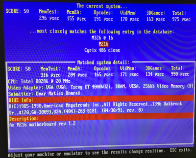

Hey guys,
I just finished a 486 DX4-100 full tower build, with the following specs:
MB: ASUS 486SVGOX4 ver 1.5
CPU: Intel 486 DX4-100 (added a cooler w/ fan, even though it works very well in passive mode too, with temps between 40 - 50C. With the cooler it stays at 20 - 25C, depending on room temperature)
RAM: 32 MB FPM 60ns non-parity (overkill, I know)
VGA: ARK Logic ARK1000PV VLB 2 MB (nothing special, but did not notice any compatibility issues during my tests) / Edit: as it turns out, this is actually a very special video card - one of the fastest VLB cards (faster than Tseng ET4000 cards)
Sound: Creative Sound Blaster 16 CT2290
IDE Controller: unidentified Winbond W83757AF based VLB card
Storage: SD to IDE with 2 GB SanDisk Ultra card
PSU: 200W Enhance Electronics (a very high quality PSU, which even has fan speed control based on temperature - I didn't even know this was a thing back then. Of course, I replaced all capacitors with new Nichicon & Panasonic low-ESR caps, even though the original Nippon Chemi-Con caps were still in top shape)
OS: DOS 6.22 + Win 3.11 (also tested Win95 and it works surprisingly well, but I feel like the DOS + Win 3.11 combo is just... cool)
For the most part, things went smoothly. The biggest issues that I had were related to the VLB IDE controller (intermittent file corruption). I tried two almost-period correct 1 GB/2 GB disks, tried an SD to IDE adapter - same issue with all. Also tried various geometry settings and nothing worked. Eventually I realized that the problem was related to LBA (seems that this controller is buggy in LBA mode). So I settled for the LARGE addressing method and the corruption problems have disappeared. Because the PC is also dead silent, I just gave up on full period-correctness and went with the SD to IDE adapter option (these old HDDs are unusable when it comes to noise).
The Turbo button works very well - better than on my other 486 builds (the 3DBench 1.0c score drops from 65.6 FPS down to 24.8 FPS). If I disable the L1 cache with setmul, I get 10 FPS in 3DBench 1.0C, which is more or less equivalent to a 386-25 speed. This is all the speed flexibility that I need!
I'm still debating weather to keep the SB16 CT2290 (which is 'cooler'), or stick to a good ol' non-PNP ESS ES1688 card, which, in my opinion, is much better in every way (+ ESFM does not bother me at all, I really like it).
I was still unable to make the CD-ROM work with the SB16 IDE connector (yes, it's IDE, not a proprietary Panasonic/Mitsumi/Creative connector). I'm guessing I need some drivers besides the normal sbbasic pack, but didn't have time to look further into it.
If anyone has any suggestions/recommendations, let me know. 😀

I finally gave up on the SB16 IDE connector. No matter what I tried, it didn't work and the CD ROM driver would freeze during loading (I tried two different SB16 sound cards, same issue).
So I just moved the CD-ROM drive on the lower bay and used one IDE cable to connect both the SD-to-IDE adapter (master) and the CD-ROM (slave). Everything works perfectly now. 😀

The IDE port on the Sound Blaster card is usually set to tertiary port so as to not conflict with the primary and secondary ports that may exist on the motherboard. Assuming you don't need to initialize the IDE port on the sound card through a separate utility, you can specify that the CD-ROM device driver look to the tertiary port on the command line. For example, if you're using OAKCDROM.SYS, use:
device=c:\drivers\oakcdrom.sys /d:OAKCD001 /P:1e8,12
You can experiment with the ports using the common values for parallel ATA:
  • /P:1F0,14 (primary)
  • /P:170,15 (secondary)
  • /P:1E8,12 (tertiary)
  • /P:168,10 (quaternary)
1F0 is likely your primary IDE on the VLB card and 170 would be the secondary IDE if it had one. Most DOS CD-ROM device drivers support the /P switch to specify a port. If yours doesn't, you may want to try a different device driver.

Reply 12 of 30, by Intel486dx33
Nice case.
I have a similar build.
32mb might be to much for DOS but not for 3.x
Win3x can use that memory no problem.
The problem I had with my VLB controller was supporting large hard-drives. The driver for the VLB controller will only support up 410mb hard-drive. If I used a larger capacity hard-drive the driver would report an error and only run at 16-bit mode and not 32-bit mode.
So slower data transfer rates. But it still runs fast enough for DOS and Win3x.
Win3x VLB driver would report an error to an only run at 16-bit mode.
So the VLB card is useless in 32-bit mode if you use a hard-drive larger than 410mb.
I don’t know how the driver would react to an SD card however.
Did your VLB controller report any errors with the SD card ?
Anyways it should run fast enough even if the SD card is running in 16-bit mode.
Also I was able to down clock my 486dx4-100 to a 286@20mhz.
So you should be able to do the same.

Reply 14 of 30, by bloodem
Intel486dx33 wrote on 2021-01-10, 17:44:
The problem I had with my VLB controller was supporting large hard-drives. The driver for the VLB controller will only support u […]
Well, to tell you the truth, I have no idea if it currently runs in 16 or 32 bit mode. I usually only try and fix if there is an actual performance issue worth fixing. 😀
In this case, the storage performance is so good, that, once I fixed the disk corruption problems, I did not give it a second thought. And I didn't even run any benchmarks, but the thing is so snappy that everything loads instantly 😀
DOS boots in a few seconds (and there are quite a few things that I load in config.sys/autoexec.bat - like the sound/mouse/cd rom drivers). Same with Windows 3.11... I just type "win" and I'm already at the desktop. 😀
No errors at all. It just refuses to work properly in LBA mode with any disk - period correct or not. I could have probably fixed it with a DDO, but I was lazy and went with LARGE mode instead, which works great.
Link: Re: 486 Multimedia dream build ( 1993/94 )
I now upgraded the L2 cache to 512KB, and the speed with a disabled L1 cache has increased significantly - 15.6 FPS in 3DBench 1.0c, up from 10 FPS before, which is now deep into 386 DX-40 territory (not something I particularly like).
However, I just realized that I did not test with L1 cache disabled + turbo off, I imagine it should be slower (hopefully not too slow). Unfortunately the PC is already in storage, but I'll definitely need to test this in the future.
