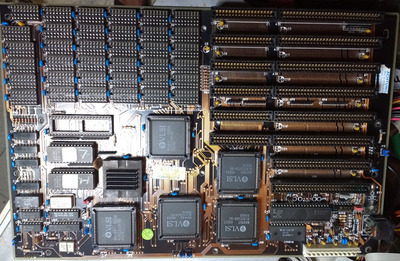

Where i can find a table for the chip equivalent for this kind of ram
The mobo is a unknow 286
41256 = TMS42256-10nl or =
411000 ?

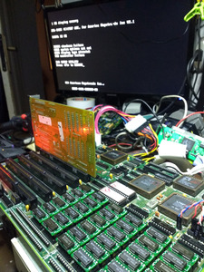

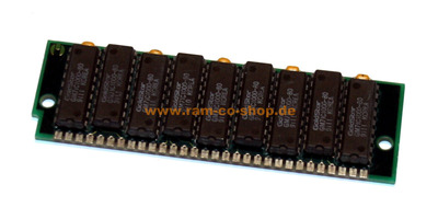

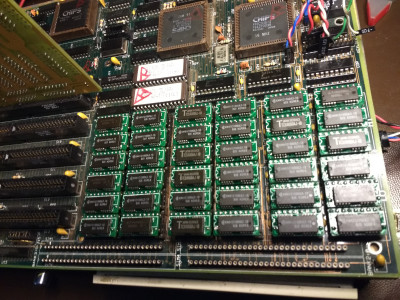

To partially solve the problem I made myself this adapter, disassembling a 1Mb simm and patiently reassembling the chips on the adapter, as soon as I get the 286 card I will test them

No that was only the card on which to do the functional tests I used them on other cards where there were no alternatives. o 36 original ram chips for 40-50 euros, or adapters with 0.5 € per chip (since I have removed the rams from faulty SIMMs)
