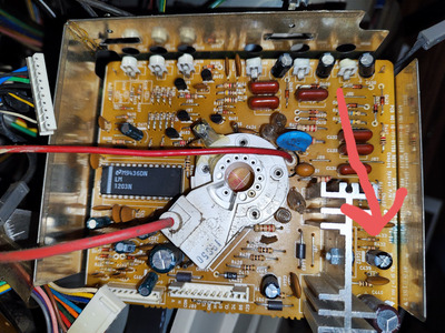

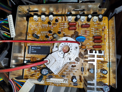

Hi MyDuck,
can you tell/show me wich Capacitor on your Neck Board was Defective? Is there a Listing what Caps go in the Neck Board?

Reply 22 of 23, by Myduck

Hi MyDuck,
Hello Jonsey, I'm not 100% sure but I think you are looking at this capacitor:
file.php?mode=view&id=147160
It's a 100uF 25V capacitor. To test it, take it out of the board and test with a multimeter in the Ohms range and see... if the resistance is very low it is likely shorted.
Hope that helps.
