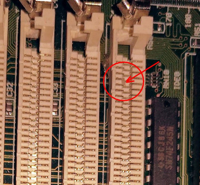

Reply 20 of 42, by Odiseo
snufkin wrote on 2021-06-07, 20:57:
Is there something between the slots 3 & 4, near the top?
I tried to pry it out but it disappeared under slot 3.
Joseph_Joestar wrote on 2021-06-08, 09:10:
Did you try different RAM sticks in that board?
It's possible that you fried the sticks you inserted backward and that the board is still fine.
I have two other modules, which I inserted into Bank 0. No result: still long continuous beeps after turning on the system.

Reply 22 of 42, by snufkin
Odiseo wrote on 2021-06-08, 16:57:
So there was something there? Could you tell if it looked metallic? Either way, probably want to get it out of there. Try holding the board vertically and gently tapping the edge opposite where that fragment went under slot 3, see if you can persuade it to come out again. Or try using a needle to pull it out. If you can get it out of there, then post some new pictures of the area. If it is metallic then it could have shorted out a couple of pins on the simm slot, which at the least would cause memory faults.
Reply 23 of 42, by Odiseo
mkarcher wrote on 2021-06-08, 17:29:
After the system failed when you set it up for 150MHz, did you switch back to 133MHz? Double-check the speed jumpers. Continous beeps might also occur when the processor can not handle the speed you request, so you might want to double-check the speed selection jumpers.
I checked a few hours ago and, apparently, I had reset the jumpers to 100MHz (the board's initial speed) on Sunday.
snufkin wrote on 2021-06-08, 18:16:
I did all of that. I didn't see the fragment again.
I'm quite angry with myself. I made pictures of all the FP header cables for later reference, but not the RAM slots with installed modules. This stings. I was looking forward to computing with a Socket 7 system.
I'm calling it quits with this motherboard. I might get another Socket 7 board.
If anyone wants to have this motherboard, don't hesitate to tell me. You can have it for free, including the two RAM modules.
It's a Chaintech 5IEM0.1 (2A59CC3AC-00). Details about the board are available here and here.
Here's a list of other things I can throw in for you (off the top of my head): two graphic cards (one ATI Rage, one possibly broken Voodoo 3 PCI), more RAM modules (EDO/FP, SDRAM, DDR1, DDR2), processors (two P4 chips, one Core2Duo e6320), one 5.25" floppy drive, two PCI modems, two serial ports.
All of that is for free. Just tell me if there's something you're interested in. You can send me a private message.
Reply 25 of 42, by Odiseo
snufkin wrote on 2021-06-08, 20:53:
If you haven't already, might be worth one last try plugging memory and cpu back in. You've moved that fragment, so you could see if the behaviour has changed.
I did so after I had tapped on the side of the board and tried to pry under Slot 3 with a needle. Same result as before: long continuous beeps.
I so wish I had made pictures of the RAM modules in their slots when the system would still POST. However, there is nothing I can do about it. If there's a way to fix it, then I'm far from tech-savvy enough to do so.
Maybe someone else on this message board could pull it off. That's why I'm offering it for free.
Most of the other components I listed are still functional. I don't have a use for them, but taking them to my nearest recycling centre seems like a waste. Anyone who is interested can have all of it for free.

With that weird something between the slots, either it moved somewhere and is causing a short, or perhaps the chipset has been damaged. Either way I would expect another mobo to work. Hopefully the RAM sticks survived too but those can be damaged as well now.

About the photo: I see a speck on one of the contacts, couldn't it have prevented the module's contact with the slot?
    165.66 KiB
    185 views
