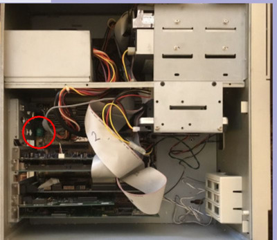

Reply 21 of 24, by Ydee
I strongly recommend replacing the barrel battery, if it is still original - they like to leak and the electrolyte eats up the routes and components on the board.
    60.99 KiB
    84 views

Reply 23 of 24, by Intel486dx33
Ydee wrote on 2021-06-10, 10:43:
Yeah, that’s another thing I need to fix so I guess I have no option but to take this computer apart and fix the problems.
