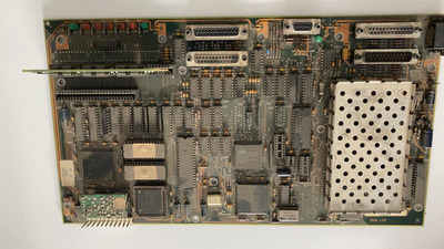

Does anyone know what this motherboard is?

Not sure but there seems to be an onboard amd 386sx on it? There is also an onboard cirrus logic vga?
Reply 4 of 15, by weedeewee
It would be easier to tell with the board dusted off and the photo in hi-res.
all I can say about it, looks like an industrial board.
Do not ask Why !
Reply 5 of 15, by appiah4
weedeewee wrote on 2021-06-28, 19:15:
I asked for closer shots of the stickers on the mainboard but we'll see if the seller provides them.
I can't even begin to guess what this was used in..

Has the seller sent you any more pictures ?
Did you buy it ?
I'm 100% certain that someone knows what it is. It's just that those somebodys aren't here to answer you. 😋
Do not ask Why !
Reply 10 of 15, by BitWrangler
Looking like some kind of POS, industrial or data acquisition doohickey.
Reply 11 of 15, by appiah4
weedeewee wrote on 2021-06-29, 16:30:
Did you buy it ?
No new photos yet, I dont want to buy it unless I know I can use it.
Could this be from an old ATM?
Reply 12 of 15, by BitWrangler
I wouldn't rule it out, being an ATM board... connect it to a printer when you first fire it up in case the buffer is still full of $50s 🤣
Reply 13 of 15, by appiah4
So, I have new photos. What the hell is this? 🤣
Reply 14 of 15, by appiah4
OK so it seems to be some weird computer model B28 LCW?
https://www.oocities.com/siliconvalley/pines/ … TOSPictures.htm
that looks like.. this?
Which makes sense as Unisys was kinda prevalent in banking etc. in late 80s here..
Also, a slightly relevant wikipedia page: https://en.wikipedia.org/wiki/Convergent_Tech … perating_System
So it's a 286 motherboard I guess? Worth picking up and trying? Don't think it would work in any reasonable kind of PC enclosure though..
Reply 15 of 15, by Schule04
It almost certainly won't play retro games if that is what you want. In fact it might not even have a standard BIOS.
The CPU is that intel chip and indeed loks like a 286. Not sure about video output, might be EGA, VGA or something completely proprietary. Also there are no standard extension slots so i'm not sure how you would connect any disk drives to it
