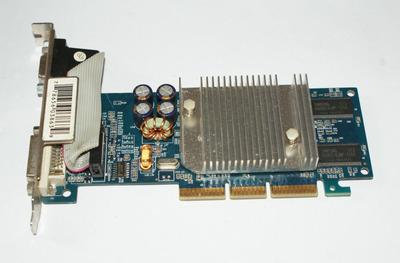

I got this Geforce FX 5200 128 MB ram 4x AGP in my retro gaming box but the poor thing is dieing slowly. This was a garbage card even in it's own days. For old DOS games and majority of the Win98 games it's usable however when you start going more upscale like Sacred 1,2, Morrowind, QuakeSpasm, Dungeon Siege 2, Never Winter Nights 2 this card shits itself together basically those games are unenjoyable with it anymore.
I'm looking something to replace it with preferably NVIDIA and preferably the same mini form factor because I use this box with a plethora of different OSes not just microsucks but old linux, bsd, solaris distros which just hate ati.
As you can see this card fits into mini PCs with a trick if you take off the black plate and throw the VGA out, don't need that anyway since I'm only using DVI.

I think the 6200 will be the winner for me as it has a slim form factor with passive cooling just like the current card.

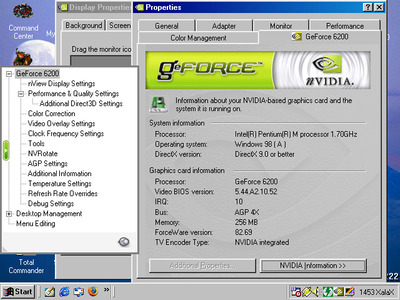

I have downloaded this 512MB patch: "PTCHNVSZ - Win9x patch for 512MB nVidia Graphics Cards "
Now this is a bit promising, for this you will need the 82.69 unofficial Nvidia driver. (BTW after installing just this driver it's the same machine dies issue).
So after patching this driver and rebooting a couple of time finally I get back the 16 bit and 32bit mode but with some very weird resolutions such as 720x576
and nothing like 800x600 1024x768 etc can be added but now at least I have color image and the Nvidia control panel seems working.
However this driver is pretty screwed up in this state because Quake3 and any gl games cannot initialize the GL subsystem and even 2D games like Diablo Hellfire refuse to start anymore with video error which is just bad 🙁

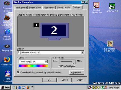

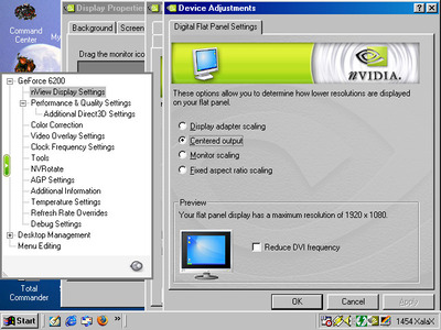

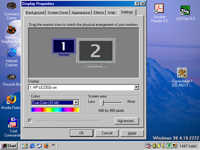

As I have said without that 256MB patch I can't even get any driver to work and that is locks you in using the 82.69.
Anyway I have figured out that much that the problem is that I cannot set the resolution. I have pretty much tried everything, disable the second monitor, reenable it. Interestingly on that I could set any resolution what I want. There is no second monitor connected to the machine of course.
I have now replaced the monitor to a HP Prodisplay P221 same thing, resolution cannot be changed.
No it's not a problem with the monitor because these monitors worked fine with the FX5200 in Win98 in all resolutions. As these are 2013+ monitors there won't be any driver for them but I doubt it's even needed.
Oh yeah I even installed PowerStrip as it was suggested in some other thread, cannot change the resolution even with that.

Ok guys I actually fixed this, here is the solution for those who will have the same card, same issue:
Use forceware 81.98 instead of the unofficial 82.69
This solved everything, driver works with the 256 MB limiter patch in both Win98SE and WinME.
Thats a lie that the patch can only patch the 82.69 version.
