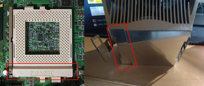

Reply 11 of 19, by konc
Veo wrote on 2021-07-15, 12:50:
- I tried installing the CPU heatsink the other way around so that the heatsink cannot be lifted on one side, however i wasn't able to install it that way at all. i'll try taking a pic later which hopefully shows how i installed it
No need to try different things, just make sure the marked sides match

This really was the problem! I totally did install it the other way around. It can still be lifted EVER so slightly but it sits far far more firm on it than before!
