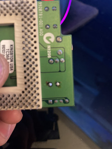

Reply 21 of 41, by Sphere478
snufkin wrote on 2021-12-20, 20:46:
Ah, missed that, I'd already downloaded a pinout that had them labeled BF2, BF1 and BF0. […]

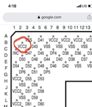

Sphere478 wrote on 2021-12-20, 20:39:
Nc is the label for the right most bf pin on the schematic I uploaded. […]
says 2x/6x is BF[2..0] = 110b.
I don’t understand
Edit, ohh! So we want bf 0,1 on and bf2 off?
Not sure how to describe this, but when giving the setting of a bus of several lines, like BF[2..0], the setting will be in the same order as given in the square brackets.
So BF[2..0]=abc means BF2=a, BF1=b and BF0=c. So BF[2..0]=110b (b for binary, would also make sense to give it in octal/hexdecimal) mean BF2 and BF1 set to '1' and BF0 set to '0'.
Okay, so then this should be be 6x 2.020v
That should be bf0 off, and bf1 and bf2 on

Reply 23 of 41, by snufkin
Let's see. SW[1..3] = BF[2..0] (from your earlier tests).
SW[4..8] = VID[0..4] (using VID[0..4] from the 5057 datasheet).
So SW[1..8] should be '11000000'b for x2/x6 @ 2.05V (officially, from the datasheet). I think. I frequently get things back to front, so best to double check.

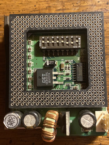

Reply 26 of 41, by Sphere478
It seems that configuration results in 300 mhz so somehow It is set at 4.5x🤔
But good news! It works! Lol

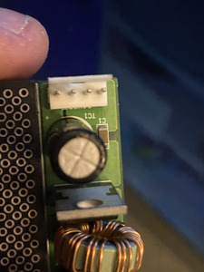

That plug on the side of it is like a floppy but not a floppy, can anyone confirm what’s going on there? Worried that the 5v and 12v maybe are supposed to be reversed because the way it’s wired now it looks like it’s regulating the 12v?
Sphere's PCB projects.
Reply 27 of 41, by snufkin
Hmm, looks like I got things back to front. When the switch is on that ties that line to '0', when the switch is off then it gets pulled to '1', either through internal pull ups in the 5057, or via those 330 ohm resistors for the BF lines.
Just to check I've got that right now, does setting SW[8..4] to : on,on,off,on,on set the voltage to 1.85V? That's what I think should be VID[4..0]=00100.
If that's right then SW[8..4] all set to off sets the input to the voltage regulator to all '1's, which from the datasheet is 2.0V (pretty close to the 2.02V, but then so would all on, which would be 2.05V).
SW[3..1] set to on,on,off. That's BF0=on='0', BF1=on='0' and BF2=off='1'. So BF[2..0]=100b.
Still doesn't match up though. The table I linked before has 100 as being 2.5x. 4.5x should be 000, which only happens if BF2 is being ignored. 2x should be BF[2..0]=110, so BF2=SW1=1=off, BF1=SW2=1=off, BF0=SW3=0=on.
Switch 3=on, 2=off, 1=off.
Reply 28 of 41, by Sphere478
snufkin wrote on 2022-01-07, 22:30:
Hmm, looks like I got things back to front. When the switch is on that ties that line to '0', when the switch is off then it ge […]
So which one should I try for 2/6x? You lost me.

Reply 29 of 41, by snufkin
From the K6-2 (is that what you're using?) datasheet it seems the BF[2..0] setting of 110 (so off-off-on on SW1,2,3) is either 2x or 6x depending on the stepping of the CPU. From the datasheet: "The ratio selected is dependent on the stepping of the Model 8. The 2.0x ratio is supported on the Model 8/[7:0], whereas the 6.0x ratio is supported on the Model 8/[F:8]"
Thing that bothers me is how it's getting 4.5x, that doesn't make sense give your last photo showing the switch settings. If you do take the CPU out, could you check if I've got this diagram labelled correctly:

Reply 30 of 41, by Sphere478
snufkin wrote on 2022-01-08, 17:20:

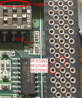

this is how it is wired

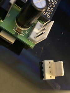

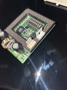

Reply 31 of 41, by Sphere478
Btw, this also needs to be talked about 🤣
1.92 MiB
1486 views
Here is a actual floppy style connector installed on the same pins.
1.37 MiB
1481 views
Where is that 12v line going?😑
1.49 MiB
1476 views
1.4 MiB
1476 views
Anyway, I confirmed the red wire is going to the mosfet, so that’s good. And since I didn’t flip the connector all should be the same as before which did work.

Reply 32 of 41, by snufkin
Sphere478 wrote on 2022-01-08, 17:43:
Ok, so those are back to front to what I thought from the earlier measurements. So SW3=BF2, SW2=BF1 and SW1=BF0. That makes things a bit less confusing.
Do you know if the other side of the switch all go to Ground, and if the via in the middle of those 330 ohm resistors goes to something +ve (probably +5V)?
[edit: That +12V probably goes to pin 8 of the RC5057M, it'll be the VccPower input to drive the MOSFET gates.]
Reply 33 of 41, by Sphere478
I forget if we finally solved this or not but here are the settings for 2x = 6x
1 on
2 off
3 off
Reply 34 of 41, by snufkin
Once we got the order of SW->BF correct, that makes sense. The one that doesn't make sense is the 4.5x multiplier. From the photo, you had SW1 off and SW2&3 on. Which (now we know the correct order) should have been 5x, but you got 4.5x.
Maybe your SW1 is stuck on, so BF0 is always connected to ground.
Using the AMD and 5057 datasheets I've put together what I think are the SW settings, would you mind checking a few to see if they're correct:
176.87 KiB
1442 views
Reply 35 of 41, by Sphere478
snufkin wrote on 2022-02-11, 11:43:
Once we got the order of SW->BF correct, that makes sense. The one that doesn't make sense is the 4.5x multiplier. From the ph […]
Holy crap man, you took the time to make that?! Good job! You are a forum treasure!
I don’t think the switch is stuck as I had to set it to get from 366 to 400
It may be simply the board detecting and displaying wrong. Some bioses are like that.
I will try to confirm this next time I have the device out.
