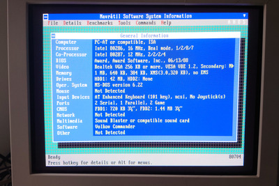

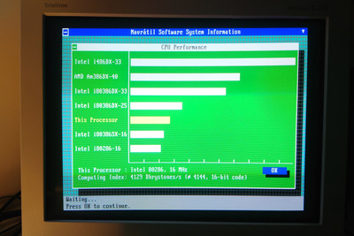

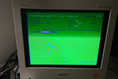

Hi all,
Well it took a some time to get oscillator and change it, but... oscillator wasn't the issue. After soldering work, there was the same behavior. So, forced to find I guy with measurement tools to check existence of 16Mhz on the motherboard. We found out that there is no problem with oscillator as we found these 16Mhz.
In short, two RAM chips was faulty. They was working fine on 8Mhz and passed the RAM tests, but issue came out only when CPU was working in 16Mhz.
Attached tests with faulty RAMs and when they was swapped to another + sysinfo and CPU performance 😀
So, now it works fine and the restoration project is almost finished 😀
Thanks!
