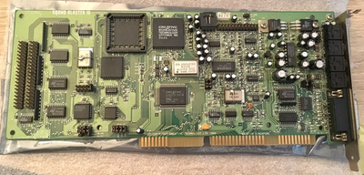

I'm trying to get a nice SB16 for my rig. I feel it's a bit expensive, right ?
Seller's picture :

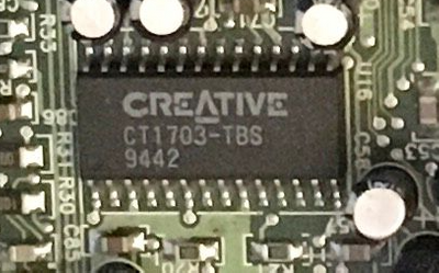

Worth it, not possible to answer. It is probably the price they go for. It is not totally outrageous at least.
If you are interested you should check the dac chip and that it said ct1703-tbs or ct1703-a. I have a ct2290 with the ct1703 chip and it is dead silent in regard to noise.
The picture is too low quality to make it out but it might say ct1703-tbs.

Reply 7 of 34, by NyLan
Joakim wrote on 2021-09-06, 18:49:
It's a ct1703-tbs
179.77 KiB
731 views
The one you have ?

Reply 14 of 34, by Joakim
I have the ct1703-A. According to this: Sound Blaster: From best to worst they should be equally good. I don't know.
I won't go into the discussion on if it is worth it. It is a 30 year old sound card after all and can have sorts of issues. I'm happy with mine and it replaced my vibra.
