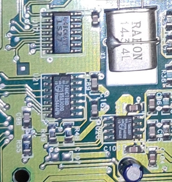

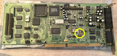

Reply 24 of 34, by Joakim
Ydee wrote on 2021-09-07, 09:23:
What's that mod with the capacitor?
Keen eye. Yes that looks strange. This is a pic from my card.
247.75 KiB
1123 views

For me this wasn't a big deal unlike the single-cycle DMA clicking bug. If the OP doesn't intend to use the MPU-401 on this card at all then it's a moot point.
I've seem some modding that improves the output quality on the SB16 such as boosting the bass response. For this one it doesn't seem very clear though.

Reply 30 of 34, by NyLan
This
658.12 KiB
1028 views
However I found at least 1 other 2290 card with the same thing on Ebay.

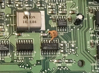

Reply 32 of 34, by Einherje
Ydee wrote on 2021-09-08, 08:45:
Yes, I know, but I wonder what the modification brings - less noise, cleaner sound, more pronounced heights/bass or something else?
Good question.
T74LS08 is a Quad 2-Input AND Gate.
Neither the ceramic THT cap, which connects 4Y to the ceramic SMD cap, or the trace between the SMD cap and Vcc are on the original design:
I don't know a lot about IC, but what would you hope to achieve by routing one of the four data outputs back to to the power input?
Maybe someone can enlighten us? I've found the data sheet for T74LS08 for anyone interested:
https://einherje.dk/vogons/T74LS08_datasheet.pdf
Reply 33 of 34, by mkarcher
Einherje wrote on 2021-09-08, 12:48:
A 74LS08 is in the digital side of things, so this capacitor does not influence frequency response, and also very likely not the noise level. A capacitor between a power input (a fixed voltage) and an output of a logic chip forces the logic chip to work harder when the output switches between low and high, because every time the output goes high, the capacitor needs to be discharged, and every time the output goes low, the capacitor needs to be charged. This extra work causes the gate to act slower, up to the point where short pulses are suppressed completely. So the purpose of this capacitor might be a slight delay of one signal, to allow more processing time for other signals, or to suppress short glitches on a signal.
Another purpose could be that when you power on the card, the capacitor is discharged, forcing the output pin to be at the same level as the power pin, which will create a short moment where the output is high, no matter what the inputs are.
While I have no proof, I highly suspect this capacitor is used to improve ISA compatibility with certain mainboards.
Reply 34 of 34, by Einherje
mkarcher wrote on 2021-09-08, 14:04:
This is interesting! Thanks for explaining
