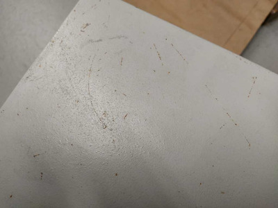

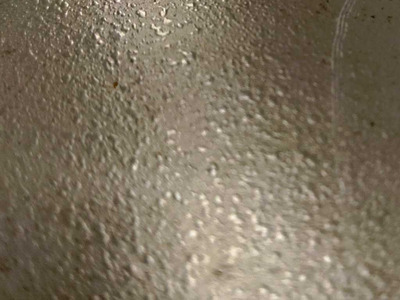

Hi,
I've got a beautiful, but old case thats hood I probably have to grind down to the bare metal because of some deep scratches and corrosion.
36.2 KiB
2021 views
surface structure
GPL-2.0-or-later
How can I recreate or mimic the original surface structure (e.g. with a paint roller)?
56.58 KiB
2021 views
Hood with scratches
GPL-2.0-or-later
TNX & regards

Krylon have some textured finishes I think. But you could do it I think by using a "rust paint" thinned down to milk consistency to roller on, lay down a couple or three coats for base, then dip old toothbrush in full strength paint and splatter it all over, using a popsicle stick to draw across the bristles. Might need a test to see if paint needs thinning a touch for right splatter.

I had always wondered how such a texture was created. Perhaps spray on 1 or more coats, when the last coat becomes tacky, make your air gun "spit", maybe the very last coat would need to be thicker for this to work.

I sprayed the paint into a roller pan and used (as you assumed) a small foam paint roll.
After a little while, the spray paint thickens a bit and that did the trick and smoothed down the most scratches.

Chris had it right I think, they just twiddle the nozzle on the spray gun so it shoots bigger blobs, or turn the pressure down so it doesn't atomise it right.
edit: If you wanted to do it with a spray can, you can kinda hold the nozzle half down so it restricts pressure and splatters... but that's probably easier to achieve with one of those clip on handle/trigger assemblies for spray cans.

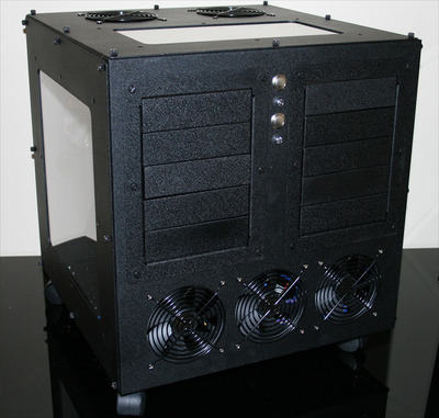

If I needed to paint a case, I'd be tempted to try wrinkle paint. It's a common finish on lots of older electronics, but I've never seen it on a computer. I thought there would be at least a few images out there from other adventurous souls who have painted their computer case with this stuff, but I could only find one. I remember a friend years ago who painted his high end Masi bicycle with black wrinkle paint, and I thought it looked cool in a sort of reverse snob way.
Reply 18 of 28, by BitWrangler
AKA crackle finish I think.
edit: mmmmkay I'm checking up on myself and there's a newschool crackle that is a crazed finish crackle making a lighter tone show through cracks, rather than the old school crackle which was having it crazed with wrinkles rather than cracks in the same color.
