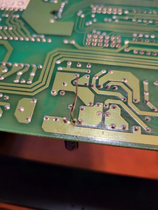

The other day, I was pulling my MPU-IPC-T card that I got from here a decade ago to put in another machine, and I wasn't paying enough attention. The leg on the 10V 100uF cap at the top of the card snapped. I carefully removed the cap, desoldered the leads on the cap with copious amounts of Rosin Soldering Flux, and put the card aside. Today my caps came in so I went to solder them on. It was at that point I realized that I had lifted or destroyed the solder pad on the negative lead for the cap. Of course I didn't notice it until after I tried to solder the new cap on. I am frustrated with myself, I used low heat(I think? 180C is the temp I used), I used my solder sucker, and I added new solder along with the flux, and I still damaged it. It appears to go into a large fill and there are other pins that stick out into the same place, but they appear to be things like resistors. Is there a specific point that I can run a bodge wire from the negative lead on the cap to in order to get the card working again? Apologies if this is in the wrong category. Please take a look at the pictures and make suggestions?

Reply 1 of 14, by retardware
What I would do first is to clean up the mess. There is a lot of excess solder that could lead into shorts.
Suck it away, clean up the board with Q-tips and alcohol so that no flux residues remain.
Make sure that traces on the component side are intact, if there are any.
Then replace the cap and add the bodge wire.
Personally I prefer a temperature between 350-400 celsius, so there is enough heat reserve in the solder tip and I get clean shining surfaces and good connections with very short soldering times.
This makes removal of such caps easy too: just heat up both legs simultaneously a moment, then pull them out, and after that suck out the hole so it is open.
The traces tend to come off when one solders too long, no matter the temperature, so it is important to work quickly.

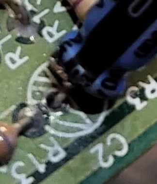

Reply 2 of 14, by nathanieltolbert
After taking the picture I cleaned the board with a small brush and 91% Iso and the flux is pretty much gone except for a small amount round the hole that lost its pad. There is no trace. As you can see in the picture, it just ends in a large green area on the PCB. Is that a ground plane or something? It is the negative leg of the cap. The new cap has already been installed. Where should I run the bodge wire to?

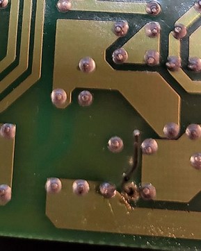

Reply 4 of 14, by nathanieltolbert
Wow, that card you have there looks different from mine entirely. I did the best I could, as I have put away my solder tools, and couldn't remove the cap I put in. I know it's blurry, but I cannot really tell if there is a solder point on the top. Here's a cropped shot of the area.

Reply 5 of 14, by keenerb
Looks like it's connected to the ground plane to me, which makes sense if it's the negative lead.
The back of that card looks different but only the traces, the component placement looks the same to me.
Look at the R1 solder joint at the top-left corner of your picture, how it looks sofr of like a crosshair or X? Does the capacitor hole have that same sort of X?
I really think you could just bridge that capacitor lead to the ground plane pretty much anywhere.

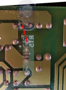

Reply 9 of 14, by snufkin
Picture here https://upload.wikimedia.org/wikipedia/common … d_mpu-ipc-t.jpg shows the big copper pour area that looks like it connects to the shield of the rear panel connector, so is probably ground. It looks like the leg of R15 closest to the capacitor connects to this area. If you've got a multimeter then you can check to see if there's a connection between R15 and the back plate. From your photos it looks like the -ve leg of C2 also connects to this area. If that's all true then the neatest way might be to put the capacitor in place as normal, solder the +ve leg, then bend the -ve leg to touch the solder pad of R15 and solder them together. Make sure the legs of the capacitor can't touch each other, you may want to put a bit of plastic sleeving over the -ve leg.
21.3 KiB
644 views
I think the soldering iron should be hot enough that you only need to hold it in place for a second or two, and you might need to turn it up a bit if trying to solder to a large copper area that can conduct heat away quickly. Those spokes on some of the pads are thermal relief to reduce the amount of heat lost to the copper area, to make soldering easier. Exact temperature will depend on the iron, tip shape, solder type and what you're soldering, but Keenerb's numbers sound like a good starting point. I've also seen 350C for leaded and 400C for lead-free.
Reply 10 of 14, by nathanieltolbert
Okay. I raised my temp on my cheap little KSGER T12 solder pen and checked the board. There was a solder pad for the negative leg on top of the board, so I tried to carefully solder to that pad. The solder held, and made what appears to be a decent connection. I tested the board and it's working now. The solder didn't really seem to melt any faster than where I normally had my temp set. What in the world am I doing wrong? Let me go over my steps and help me identify where I am either missing something or doing something wrong?
