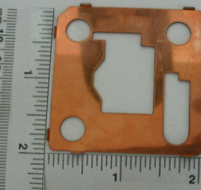

I bet those old athalon copper shims would work on these. For those who wanted to keep the IhS off. Prob have to file a little bit for clearance from some of the ICs and gold pads
May even be able to find some foam pads, make it look like a ceramic athalon/duron.
The removal of the IHS on these doesn't really help with overclocking plus the die is pretty fragile. I wouldn't want to risk using a heatsink directly on the die.
It is not hard at all to reinstall the IHS on these.
I did it back when the K6-2 chips were current and didn't have any issues reinstalling.
cyclone3d wrote on 2022-02-22, 00:35:The removal of the IHS on these doesn't really help with overclocking plus the die is pretty fragile. I wouldn't want to risk using a heatsink directly on the die.
