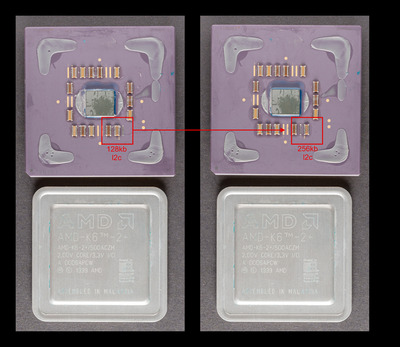

I'm surprised to see the guts of the die visible though btw.. these are pics of your actual processors? no damage to the die? the one looks like the thermal adhesive broke away from the die?

we need a step by step procedure for safely removing the lid, and for safely reinstalling it also.
can anyone tell us exactly what kind of glue was used? so we can replace the original like for like? also, will liquid metal work on this die since we now have a opportunity to upgrade it? or what should be used? perhaps a thermal adhesive?

There's a lot of contacts around the die to worry about if you put a liquid metal on there... unless you apply a conformal coating or something to all that first. You'd wanna try that before you glued the lid down really well of course.
I'm not sure if the "grey RTV" type stuff is just a firm silicone or whether that offers further thermal coupling from the heatspreader either into or out of the ceramic (Heat won't travel very well horizontally through ceramic, but it might be worth a bit of dissipation to have it going through it to the ground pins/ground plane.)
But why stick the stock heatspreader back on? Copper plate!

personally, I'd like to return the processor as much as I can to the original visual condition after the upgrade
I'm wondering if heat may be the best way to remove the ihs?

Fritzchens Fritz wrote on 2022-02-21, 05:34:
It works! 😀 After replace the capacitor back, it was still again a K6-2+ with 128kb L2 cache. Test this modification tomorrow at full speed. Today tested only with 180mhz.
anyone wanna test moving that other capacitor 🤣? wonder what that does? maybe moving both activates 512k 🤣
why do your pics show the structure of the chip? it should be one color

You can't use liquid metal with the original lid because afaik it's aluminium and that forms a very brittle alloy with the liquid metal.
Regular thermal paste should do a good job on such a low TDP CPU, no need to worry.👌

Sphere478 wrote on 2022-02-21, 05:35:
Re: Cheap k6 3+ 570 chips.
Because these are my old exposed K6 chips. I put them on the ceramic package for clarification so that you can see the L2 cache on the chips. Here is the pic of my modded K6-2+:

Fritzchens Fritz wrote on 2022-02-21, 05:45:
okay, so the previous pic is of non working chips you sanded or broke loose and flipped?
I see that there is solder on those . looks legit!!! wow! exciting!

The original "glue" is nothing but grey silicone.
I delidded a few K6-2 CPUs back in the day when I was experimenting with direct-die liquid cooling.
Clean the old silicone off the IHS and the CPU as well as the thermal paste off the die and the IHS.
Replace the thermal paste with something good such as Arctic MX-5 (my current favorite) and use a dab of silicone glue on the corners of the IHS, then set something heavy on top to let the silicone glue dry. Just have to make sure you have it well balanced so the IHS is not angled.

Reply 79 of 600, by Sphere478
Any chance you’re willing to see what that top left cap does?
