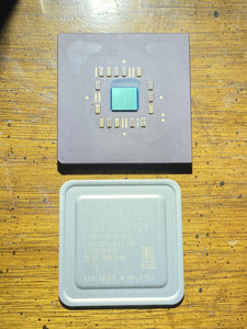

looking at my 570 here..
what is the thinnest razor blade you can order?
these maybe?
Sphere's PCB projects.

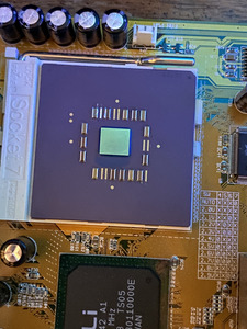

Reply 90 of 600, by Sphere478
0xCats wrote on 2022-02-21, 08:06:
Until I have seen actual proof I am very suspicious of a (capacitor) actually being able to strap cache config bit. You can't us […]
You can't use capacitors as pullup/downs for GPIO/Register bit mask strapping.
Unless that is not a capacitor, but a resistor disguised as one.
I'll be trying this myself on my K6-2+ 500ACZM.
Well, cats I’m happy to say that it’s confirmed.
(May not be a capacitor, I haven’t measured it)
I used one of the shaver blades like I talked about earlier,
Got all four corners.
Tried heat, nothing, it’s rubber like high temp rubber maybe kinda like the rubber they use on windshields. Best way to scrape it off is with a piece of rough fabric or finger nail.
I’ll try and see if some RTV isn’t basically the same. (That may be exactly what it is…)
They used the same stuff on the die and the corners on mine.
Perhaps I can order some thermal adhesive and some rtv.. will update.
Anyway after cutting all four corners it simply came down to putting a normal razor under the lip on an entire side and leveraging that side up until it went “pop” and there it was!
I cleaned up the solder a bit between the installed pic and the pic on the wood.
I gotta say, that resistor/capacitor was not easy to move guys. The processor sucked up a lot of heat and made it hard to get it all to flow. But I got it after about 20 min.
I kinda feel like I may have opened pandora’s box here leading to the possible distruction of many chips.
Guys, transplanting that cap/resistor is not easy, so be sure you are up to it. I made use of a hot air station, a soldering iron and flux paste and a lot of patience and many tries to get it.
As a retro enthusiast I must emplore you guys, please take the time to reinstall the IHS and don’t chip the die. There are only so many of these left. The more you destroy the more expensive they will become.
Enjoy, and I am very glad this hunch paid off!! A real victory for socket 7 enthusiasts today!
Don’t forget to scrape off the rtv on the die it’s a thin film. Use your thumb and a flat fabric

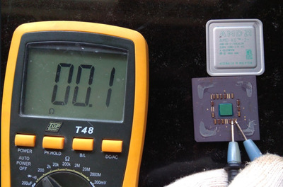

Reply 91 of 600, by 0xCats
I've just gone and measured the part and it is indeed a resistor (0 Ohm link)
There are two types of devices, those that know they've been hacked and those that don't yet know they're going to be hacked.

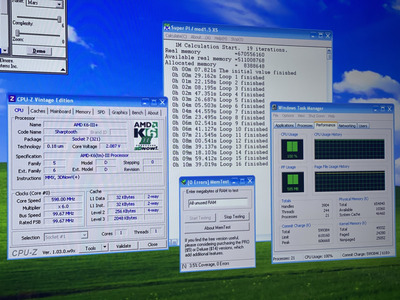

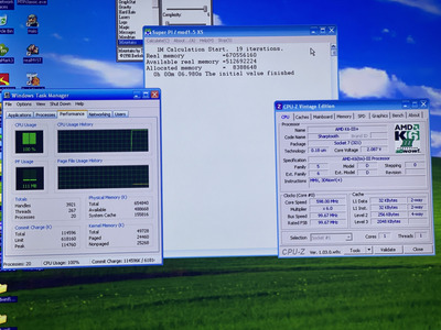

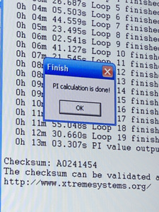

Reply 95 of 600, by Sphere478

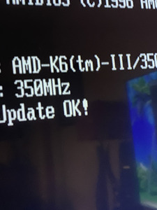

Okay, here we go.
570 for the win! (At 600mhz/256k)
Just started a super pi 1m will run 32 m if that passes
So far, no issues.
1.88 MiB
1781 views
spoke too soon super pi error, bumping by 0.1v to 2.2v it's worth noting that the heatsink I am using isn't the best it's getting kinda hot. but that in of it's self is kinda a good test. I don't wanna put one of my better heatsinks on it because the die is fragile till I get the ihs back on this one is light pressure
update 2
tryin again with more airflow over heatsink and 2.2v so far so good
update 3 ran pi for like 5 min no issues, rebooted and lowered voltage back to 2.1v (lowest board can go)
update 4 all seems fine, just a cooler getting too hot. this chip (570 2+) works fine at 600mhz and 256k
1m spi
