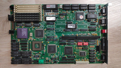

Infinity Multipro VII-386DXV
A better picture of it is here.
Through riser board, it has 3 ISA 16-bit slots.
It also has Bus Mouse port in front together with AT Keyboard.
The graphics card has both VGA and EGA (DB9) ports.
It can have cache, up to 256kB.
The JP14-JP19 is configuration for cache size. Yet again specifics are unknown, but trial-and-error approach can be used on those 6 jumpers.
It has (in its current configuration) 33MHz CPU with 66MHz crystal. So FSB is 33MHz. But i do have other boards with same chipset, that can do 40MHz. (Even 45MHz on another board is confirmed by me) But under CPU tab, i can provide nothing about 40MHz 386, but Intel 386DX-33 is working well. 😀
It has MR BIOS available for it - V020B324. (As MR BIOSes are based on chipset, not on specific board)
The integrated IO controller is 82C862 based, specifically UMC UM82C862F is on this board.
The SW2 and SW3 switchblocks control the integrated IO controller. While i don't know specifically, which one does what, then it should match all the capabilities here: https://www.elhvb.com/iocard/DLU-270.txt (And when i was playing around with the SW2 block, i was able to enable-disable serial and parallel ports and change addresses...)
The J5-J7 is Case Intrusion switch, Reset switch and Turbo switch. But i might be wrong with the order.
I recently also heared that it is a taiwanese machine that was brought to Estonia in the early years of regained independence. Unfortunately i haven't gotten any more interesting information...

Reply 42 of 162, by Tiido
🤣, I saw that board on osta.ee just yesterday.
Reply 43 of 162, by GigAHerZ
Tiido wrote on 2022-05-27, 07:20:
Yes, the full machine is looking for a new owner there.
Before i will give it over to a new owner, i did want to put all my information out there to the public so we don't lose any valuable information. 😀

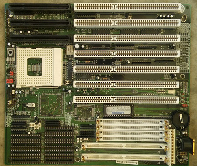

Saved the BIOS of 2 very destroyed boards. The 486 seems to be
Amptron DX-6900
https://www.ultimateretro.net/en/motherboards/572#downloads

Reply 57 of 162, by weedeewee
Predator99 wrote on 2022-08-11, 20:46:
Saved the BIOS of 2 very destroyed boards. The 486 seems to be Amptron DX-6900 https://www.ultimateretro.net/en/motherboards/57 […]
Amptron DX-6900
The Slot-1 I didnt find.
BIOS.zip
both look like pcchips mainboards to me, the amptron is already mentioned under the m912 v1.7 entry on UR, https://www.ultimateretro.net/fr/motherboards/573
There is also a patched bios to be found here on vogons for that board.
the other board, since it mentions bxcel on one of the chips makes me think it is also one of those pcchips or relabeled under a different manufacturer name, board and can likely be found in that list.
edit : https://www.ultimateretro.net/fr/motherboards/6204
Do not ask Why !
Reply 58 of 162, by creepingnet
weedeewee wrote on 2022-08-11, 21:09:
both look like pcchips mainboards to me, the amptron is already mentioned under the m912 v1.7 entry on UR, https://www.ultimater […]
Amptron DX-6900
BIOS.zip
I second on the M912 for the Socket 3. I have the exact same motherboard in my Moondog computers 486 that I got at the beginning of the year. Also, I don't think I've seen anyone use white ISA slots except PC Chips.
