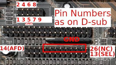

Reply 21 of 46, by snufkin
stamasd wrote on 2022-01-20, 19:29:
snufkin wrote on 2022-01-20, 18:44:
Would you mind checking which pins on the Printer and COM headers are short to Ground? That way it might be possible to have a stab at working out the pinouts for those headers as well. If those are worked out then I think it just leaves the FDC and IDE headers, and they must surely (famous last words) follow the normal pinout.
the IDE, floppy, serial and parallel headers have pin 1 silkscreened on the board. The IDE ports work and have the normal pinout. The serial and parallel port headers have GND exactly where you expect them (just checked - i.e. COM pin 5, and LPT all even pins from 10 to 24), so I think safe to assume standard pinout too. The only one I haven't checked yet is the floppy header, and I have no reason to believe it's not standard.
Ah, I wanted to check, particularly the COM ports because there are two common standards, with the ground in different places, either in the middle or at the end.
1 2      1 6
3 4 2 7 1 2 3 4 5
5 6 or 3 8 -> 6 7 8 9
7 8 4 9
9 10 5 10
Given how you numbered the USB header (1-4 on one side, 5-8 on the other side), is your pin 5 at the end? Or are you numbering them as the IDE ports, with an even side and an odd side? Given how you describe the LPT header it sounds like you're numbering that as odd + even (so pin 26 is NC)?

Reply 23 of 46, by snufkin
stamasd wrote on 2022-01-20, 19:20:
Like I mentioned above, this board's clock generator has the ability to run the PCI clock at a constant 32MHz independent of the FSB.
I know some Intel chipsets don't support async, so it'll be interesting to know if that works when you can try it.
[edit: I've marked on the photos what I think are the pins you've found (obviously waiting for when you can check the PS/2). Do they look right?]
[edit: I've updated the COM port and removed the previous picture, hopefully that's now correct]

Reply 24 of 46, by stamasd
No, I used the COM header numbering as used here: https://pinoutguide.com/Motherboard/rs232_hea … er_pinout.shtml ( AT/EVEREX ) i.e. pin 5 is in the middle. Sorry for not being consistent. The LPT and USB above are correct, PS/2 awaits confirmation.

Reply 27 of 46, by snufkin
stamasd wrote on 2022-01-20, 23:28:
That's fine, it's not like they're consistent with their numbering. I think on most cases odds/evens makes most sense. I've updated the COM port picture so hopefully that's ok now until you can test out the PS/2 port.
[edit: just thought, when you get the PS/2 header, could you check on pins 2 and 4 if both of them are short to ground, or just one? I know you've measured 0V on both of them, but maybe only one is actually tied to ground.]

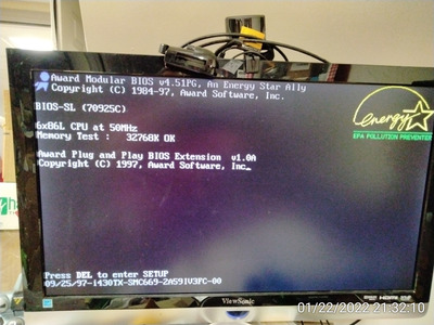

Reply 35 of 46, by stamasd
Yes it goes down to 50 MHz. It's weird to see on the POST screen "6x86L at 50MHz" but it works.
1.22 MiB
866 views

Reply 36 of 46, by Tetrium
stamasd wrote on 2022-01-22, 14:48:
I found an undocumented jumper setting for this board. :) […]
I found an undocumented jumper setting for this board. 😀
For Cyrix CPUs, jumpers JP1 and JP2 have only documented settings for multipliers of 2x and 3x (1-2, 2-3 and 1-2, 1-2 respectively) The other 2 combinations for JP1 and JP2 (2-3, 2-3 and 2-3, 1-2) are undefined for Cyrix CPUs.
So of course I had to try them. 😀
Bad news first: with JP1=2-3 and JP2=1-2, the motherboard does not POST at all at any FSB with a 6x86.
And good news: JP1=2-3, JP2=2-3 is read by the Cyrix 6x86 as 1x. 😀 So the CPU speed is the same as the FSB. This allowed me to underclock the 6x86 down to 50-83MHz. Yes, it is stable at 83FSB x1.
This is very interesting! I wonder which Cyrix CPUs can be set to 1x this way.
And nice to see this as a potential real purpose for these otherwise somewhat unremarkable CPU-curiosities 😜

Reply 37 of 46, by stamasd
So far I tested two 6x86 (one L and one non-L), specifically a 6x86-P166+GP and a 6x86L-P200+GP. It works for both. I also have an IBM 6x86L-166 which I haven't tested yet (because it needs a lot of work unbending pins) but I expect it to work also.
TBH I don't understand how it can possibly work. I'm going through the 6x86 datasheet at http://datasheets.chipdb.org/IBM/x86/6x86/6x86_ALL.pdf and this CPU only has one multiplier control pin: CLKMUL (page 3-7 in that sheet). It can only have 2 states: low or unconnected = multiplier 2x, and high = multiplier 3x. I have no idea how this board gets those CPUs to work at 1x.

Reply 38 of 46, by stamasd
Ah I think it starts making a little more sense. I was pointed to this thread from many years ago Subtle differences between Cyrix and IBM 6x86s where 1x for 6x86 was documented. The table in the first post refers to pins BF0, BF1 and BF2, which are not named so on the 6x86 according to the datasheet. But comparing the pinouts on the 6x86 datasheet ( http://datasheets.chipdb.org/IBM/x86/6x86/6x86_ALL.pdf page 5-1) and the Pentium MMX ( https://www.arl.wustl.edu/projects/archive/gi … X_Datasheet.pdf page 9) it appears that pins BF0 (location Y-33 in the latter) and BF1 (X-34) correspond in the 6x86 respectively to the pin CLKMUL and one "reserved" pin.
So if that "reserved" pin is indeed connected internally and influences the multiplier value, the findings above make more sense. And if the other combination of the 2 pin signals causes a 4x multiplier to be selected, it makes sense for the board not to POST in that case, because the minimum CPU speed would then be 50x4=200MHz, which I already know the CPUs I tested don't support (it didn't POST at 66x3 either).

Reply 39 of 46, by stamasd
Hmm yes and there is indeed a difference between the Cyrix-branded and the IBM-branded 6x86 chips. According to that table, the jumper combination that results in a 1x multiplier on Cyrix chips should give a 2x multiplier on IBM chips.
And practically, after unbending the pins on the IBM 6x86L-PR166+ and installing it with FSB=50 and JP1=JP2=2-3, it POSTS as a "6x86L-PR120+" which means it's running at 100MHz (not 50 as the Cyrix chip did). Still cool, but that means 50MHz is not achievable on this board with IBM CPUs, because there is no jumper to control BF2 and that would be the only method to get 1x for IBM.
