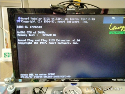

More fun. I was able to set multiplier 1x on the IBM 6x86L. 😀
A little experimenting showed that jumper JP6, which is "reserved" actually controls BF2. With the FSB set at 50, JP1=JP2=JP6 in position 2-3, the multiplier was set to 1x on the IBM CPU and it POSTed at 50MHz.
So now we know what JP6 is for.
JP1=BF0; 1-2="1", 2-3="0"
Jp2=BF1; 1-2="1", 2-3="0"
JP6=BF2; 1-2="1", 2-3="0"
This will allow setting any supported multiplier on any socket7 CPU.
    529.5 KiB
    486 views
    IBM 6x86L POST at 50MHz
    677.94 KiB
    486 views
    jumpers JP1, JP2 and JP6 set for 1x

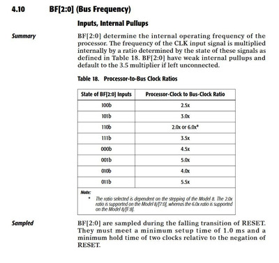

...for instance on K6-2 CPUs according to this table taken from the datasheet https://www.amd-k6.com/wp-content/uploads/201 … p_Datasheet.pdf page 92

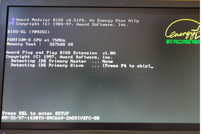

Hi stamasd, I just got the same motherboard like you and really like it for SDRAM and MMX suppot, but I have some difficulties with MB so was trying google and found your topic. I'll be glad if you or anybody else can help...
The problem is that all time I restart the computer and doesn't matter if with reset button, CTRL+ALT+DEL or just by exit from BIOS the PC won't boot up again and finish with black screen. I have to power off and power on again... I can see I have same bios version so it is not the case, any idea what could be wrong?
Thanks!

Reply 45 of 46, by Sphere478
koroner wrote on 2022-03-16, 15:34:
Thanks!
I’ve had some add in cards cause this before.

Reply 46 of 46, by koroner
Sphere478 wrote on 2022-03-16, 21:41:
Unfortunately not the issue, only graphic card is installed so I tried different one in different slot but still same, also tried boot without FDD and HDD, changed simm to SDRAM and seems like MB issue..
Strange is that if I reset before "Award Plug and Play BIOS Extensions" shows up the computer restarts normaly.... any idea?
