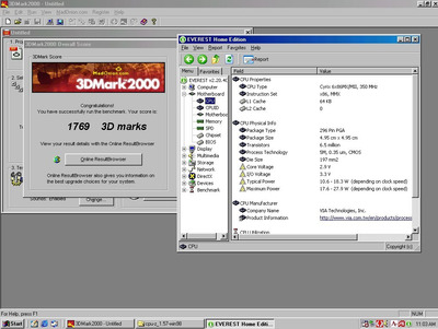

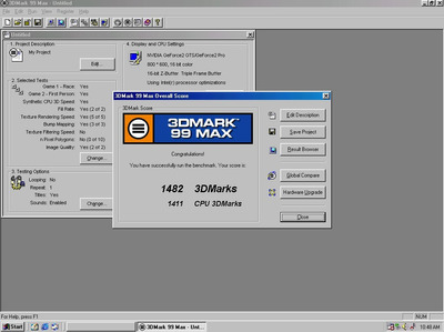

Well I didn't have time to do a ton of benchmarks, and I couldn't seem to get the Geforce 2 to install properly. I probably need to do a clean install of Windows at this point.
But regardless, what I did do was some tests with a Radeon 7500DDR and a double sided stick of PC100 128MB ram. I didn't test with the 7200 SDR or the 9250, I doubt they would be much different, same driver.
FYI the tests with 256MB of ram were within margin of error.
I do have some 64MB sticks just not sure where they are. I will have to dig and see.

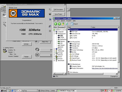

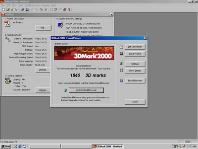

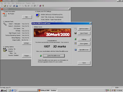

So, I decided to do a clean install of 98se and try to get the Geforce 2 GTS working.
I also installed DX7.0a and not DX8.1 this time around.
All the hardware is the same, just VIA 4n1 drivers, NUSB33 and Geforce 7.76 video drivers.
Still has both the Aureal Vortex (Sonic MPACT90 form Diamond) and the Vibra SB16 ISA card installed.
I did a run of both 3DMark99 and 3dMark2000 with stock video card clocks, then I did a another run of 3dMark 2000 but I "simulated" a Geforce 2Ti (250core, 400 effective memory).
I was really hoping to hit 2000 points but no go. At least not yet. Card is functioning in AGP2X stable.

Reply 92 of 98, by Sphere478
You are matching my tyan s1564d, 66fsb, 512mb, simm k6-3+ 400 mhz, radeon 7500, win ME now 😀
No chance you’ve found a way to get to 350 with a higher fsb have you? Drop the multi and raise the fsb? I assume you are 100x3.5 right now.
What driver are you using?
7.xx? Is what you want

Reply 93 of 98, by Jasin Natael
Sphere478 wrote on 2022-09-24, 02:54:
You are matching my tyan s1564d, 66fsb, 512mb, simm k6-3+ 400 mhz, radeon 7500, win ME now :-) […]
Read the k6-3+ aiming for the stars thread they talk about it a lot there.
I will have to read the thread for sure. That seems like a healthy result.
Yes I am at 100x3.5
I have not tried to to raise the FSB, that was actually what I planned to do next.
I didn't have a ton of luck with the K6-2+ at 112mhz fsb, but perhaps the Cyrix will do a bit better.
Now my Soyo board fared better it is rock stable at 112mhz with the handful of chips I've tried in it.
I am using 7.76 for the GTS card. Seems to be the best optimized for 3dnow and slower FPU cpus.
I did try a Geforce 4 MX440 with I think 45.23, It is a garbage 64bit memory bus card though. It scored around 1200pts.
Not surprising but it was just for curiosity sake.
I did also try the 9250se and it scored pretty close to the 7500 as you had guessed. 1686 or so. I didn't screen cap it.
That is about all of the interesting cards I have to try. I have a Geforce 256 but it seems to have died, it hasn't worked right for a long time. Bad memory I think.
My Radeon 8500 isn't REALLY and 8500, it is a FireGL 8800 card that I use the 8500 drivers with. It is a bit faster than a vanilla 8500, at least in D3D.
Nowhere near as fast as a 9700/9800. My 9800 died years ago unfortunately.
Still yeat maybe some fsb/multiplier magic can coax a bit higher scores, it's all in good fun.
