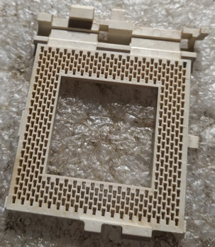

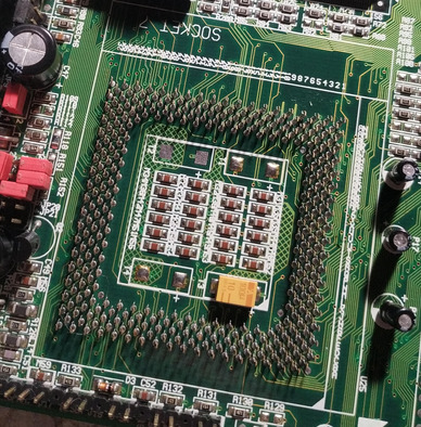

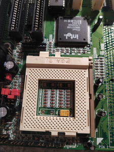

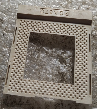

This post has been around for a while now but by chance I ran into the same problem, I myself broke the socket 7 heatsink retention mechanism. It turns out that socket 7 and socket 370 are almost the same internally so it occurred to me to disassemble a Socket 370 and transplant the necessary part to the motherboard that had the broken socket 7, the internal difference of the socket 370 is that it lacks the hole for a pin that is present in the socket 7 but it is easy clear the missing hole.
I think this is the easiest fix for this problem, no need to desolder an solder a new socket.
