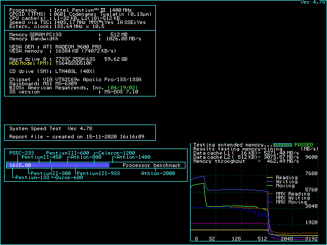

I have stumbled upon this thread while researching my new Shuttle AV18E2 (also VT82C694T chipset). By chance I have MSI 694T Pro VER 5 too and I was running PIII-s (SL5XL with 512KB L2 Cache) for some time in it with no memory related problems. I dug up this on my HDD (I no longer have this board in use):
7.66 KiB
285 views
I don't remember doing memtest specifically, but I would remember if there were any problems with memory. At least Win 98 was running fine:
17.85 KiB
285 views
If you want I can take the motherboard out of the box again and test some things for you. I have also CTCM reports if that helps. From the board related folder I also see I was using 6309v75 BIOS and I have backup of the settings stored.

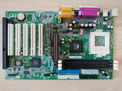

OK, no problem, I always store photos of each component:
1.88 MiB
269 views
BIOS file is "A6309VMS.750", the latest version from MSI site.
