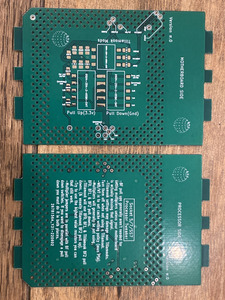

Thank you 😀 I’m sure others would have wondered also. Now they can read this 😀

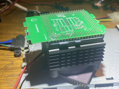

Got the prototype!
I believe I ordered this in 0.6 thickness just to see what would happen.
Here is the result:
Using a pretty light tension clip,
-I see some deflection. So 0.8 thickness is the next step. If that doesn’t work I need to open the holes up and sink the pcb into the LIF further.
-The tabs either need some kind of solder ridge like I designed into the voltage interposer, or the tabs need to be longer. But the tabs are the right shape and fit the hooks nicely. Just, they kinda look like they might slip off given the chance. Something I was expecting but wanted to verify.
