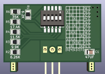

Reply 124 of 240, by CalamityLime
I done a little recalculating with the resistors and I got a larger list of supported voltages with one less resistor. The text is a bit small which is a shame, not sure how to restructure the table to be more readable.
It would be handy with there was an easy scale option in kicad 😐
Here's hoping I actually read the spec sheet right!

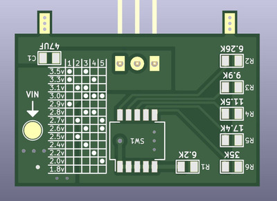

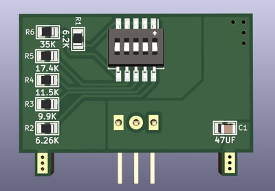

Reply 125 of 240, by CalamityLime
Alright, I think that's it.
I think I have everything wired in correctly at the moment. Traces are as beefy as I can make them, foot prints all seem right, I think everything can be hand soldered fairly easily, triple checked the resistor switch map thing.
If anyone is up for looking at it to see if anything is wrong, I'd appreciate it. I just want to go over the datasheet for the murata module again and if I have things structured correctly. Time for a break at the moment and I'll return to it later.
EDIT: I did hastily make a 3d model of the murata module, hopefully it shows up in the 3d viewer.
Not a finalised release
Just to clarify, I don't consider this done yet and it is not to be considered working yet.

Reply 126 of 240, by CalamityLime
I decided to add a input filter cap. The value of the cap doesn't really matter too much, something like 22uf -> 47uf should be fine.
It does look like it's in a really awkward place but I have to make sure nothing is interfering with pin headers, the sides of the heatsink are thick so there's plenty of clearance for resistors and caps.
I went over the datasheet for the murata module and I'm pretty sure I have everything right.
-lime

Reply 128 of 240, by CalamityLime
pentiumspeed wrote on 2022-06-19, 23:32:
Always derate the amps or watts by certain % for headroom if datasheet did not specify derating. Say you have this module rated up to 12 amps, I call this up to 10 amps times 2.0V, 20W total, For 3.3V, this is 33W. Good to include a jumper if you can to get it to 3.5V or so for some CPUs. Efficiency goes up with higher input voltage which is in your case it takes 12V which is included in the VRM module pinout, at 5V input, it might get bit more warmer.
This is why I searched and purchased few modules that is rated for 16A max so I allow for my similar projects to have 14A and another module rated for 30A (has two inductors).
Cheers,
Fair point and I have been keeping that in mind some at least some bit.
My knowledge of dc/dc modules is very limited and I'm very sceptical of many dc/dc modules, the only brand I know in the scene that's well regarded is muRata. They have a 12amp module that fits where I need it and I've seen in another thread that the 20amp module was being used in a similar scenario.
This is aimed to my board that has 2 VRM units, one with a large heatsink that steps 5v down to 3.5ish or 3.3ish, then a much smaller second one for dual voltage cpus that steps the voltage from the first vrm down to core voltage.
I can set the second vrm to be bypassed so the first vrm handles the 3.5ish, though this can do 3.5 with switches 1 & 3.
There is also a jumper on the back of the smaller vrm that lets me switch between 5v and output of vrm 1 for the input of vrm2. As a consequence I could pump 12 v in through there and I'm toying with adding like a solder pad or something to this device as a shortcut to add 12v. It's a small board, finding space is getting difficult. I wrote 5v on the schematic because the original vrm circuitry that used linear regulators ran off of the 5v rail.
If it isn't obvious, this module is aimed to replace vrm2 (the smaller vrm) that generates the core voltage.
Now onto numbers and this is where things get a little self-centered;
The most power hungry CPU that I ordered and will use if everything works, is an AMD k6 500mhz. I might try others just for fun but I'm assuming that this k6 will live in the board.
Going off of the data found on CPU world, the CPU is a 2.2v CPU that consumes a max of 20.75 watts, that works out to just under 9.5 amps which is just a hair under the 10amp ceiling that you seem to be suggesting. This would be pushing the CPU as hard as it can go which is something I personally wouldn't be doing much of. For retro computing I just want something with a bit more kick than my 486 100mhz CPU .
For 2.0v cpus that want over 10amps, you'd definitely want to look at the 20 amp unit at least, though I'd worry about the traces on the actual motherboard being an issue if the stock vrm couldn't deliver that kind of power.
I think that addresses everything, thanks for your comment!
-Lime
PS: I'm not sure I can fit the 20amp version of this module but I might give it a try.

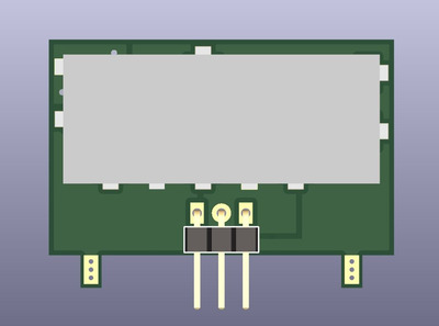

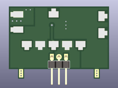

Reply 129 of 240, by CalamityLime
Rough edits to fit the 20amp version of the module.
The board is wider and taller as a result, it may still fit albeit a bit tight.

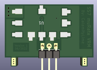

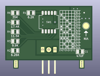

Reply 130 of 240, by CalamityLime
Alrighty!
I think that's done.
I added a test pad for an alternative way of adding a vin voltage to the murata module. I know it seems weird but it's just there as an experiment. Probably best to cover it with tape if it's not being used.
Once again I made a rough 3d model of the murata module, hopefully it'll show up in the 3d viewer.
What do people think?
I kinda grinded this board out so I can order some stuffs from PCBway. I think it's good enough to order though I'd like to look at it with fresh eyes first.
-Lime

Reply 131 of 240, by Sphere478
CalamityLime wrote on 2022-06-20, 05:40:
Alrighty! […]
Alrighty!
-Lime
1.44 MiB
549 views
1.94 MiB
549 views
The reduced cross section bugs me. :p looks good though. I’m not familiar with the schematic though so no comments on that yet.
I know this will mess everything up, but remember how you made the rear bracket? I'm thinking if you wanted to, you could make the dip face upward with a T pcb setup.
Just throwing ideas out. I don't notice anything blaringly obvious from here. But when you are the one creating it you stare at it for hours and notice all sorts of things! 😀

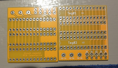

Reply 135 of 240, by CalamityLime
the tag ram mod board arrived!

Reply 136 of 240, by Sphere478
CalamityLime wrote on 2022-06-23, 13:28:
Damn, they made that one upside down…
So when are ya gonna fire it up? 😀

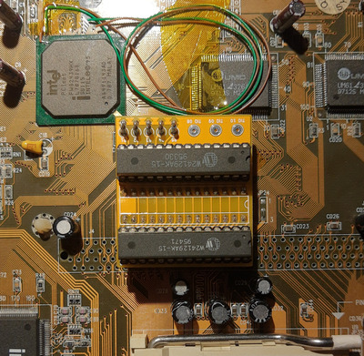

Reply 138 of 240, by CalamityLime
I assembled one PCB just to see how it looks and I think it came out well!

Reply 139 of 240, by Sphere478
That actually does look pretty good!
I think it’s gonna work also, seems like you guys got it all figured out properly.
Suggest super glue for wires.
You can route them like traces with no tape.
Hot air can pull them up later if you are careful.
