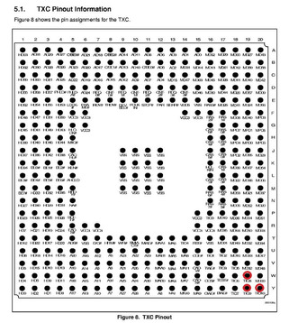

Reply 61 of 240, by majestyk

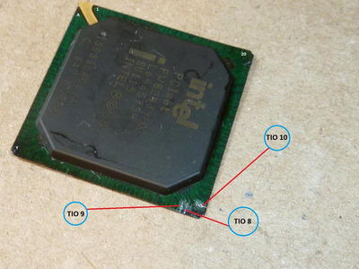

O.K. I finally found out how to reach the contacts TIO 8, TIO 9 and TIO 10 of the HX Norhbridge when they are not connected to the mainboard!
Since the one on my Jetway board is broken anyway I desoldered it. First I found that, for whatever reason, the pad for TIO 10 - and ONLY this one - was connected to a trace going somewhere (will find out where). This needn´t be the case for different mainboard models.
Then I cleaned the pads on the chip and started the measuring.
Here´s the official Intel pinout (view from the top) I marked the three I/O-lines:
153.01 KiB
760 views
Then I measured the connectivity between the 3 ballpads and the tiny traces on the chip.
This is the result:
305.6 KiB
749 views
This would not have been possible without removing the BGA chip, so the Jetway HX mainboard has been sacrificed - for science, but now it´s possible to enlarge the TAG IO-bus for mainboards with just one TAG chip that provide no connections at all.

Reply 63 of 240, by majestyk

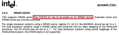

We still have to test this on a real HX-mainboard that lacks the 2nd TAG chip. It would make things easier if the existent TAG-socket was near the northbridge. The traces on the chip (in fact it´s a very thin multi-layer PCB with the actual silicon somewhere inside at the center) are quite delicate, so only very flexible and thin wires can be used. After the soldering is done and when everything works, a drop of epoxy resin could be applied.
And there´s an explanation for the trace at TIO 10:
44 KiB
734 views
This means when we switch from standard 64Mb cacheable area to the 'extended" cacheability of 512M this pullup at TIO 10 must get interrupted (due to the exclusiveness). After cutting the trace the side leading to the northbridge can be used to solder the TIO 10 wire.
This is good news - in most cases there should already be a trace connected to TIO 10, we just have to find it - then there are just 2 connections left that need to be soldered to the chip.

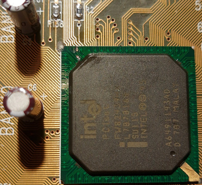

Reply 64 of 240, by CalamityLime
majestyk wrote on 2022-05-31, 15:25:

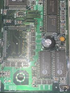

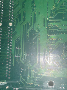

Well I poked around my board a bit and I think I found TIO 10. I'm not sure it makes sense where it goes though.
Following your image TIO10 is in the absolute corner of the chip, looking underneath my board it looks like there is a via for the corner most pin. Following the trace it lead to two of the ram slots.
Simm one and simm three
I included an image highlighting the pins.
I don't have something to poke under the chip to probe the ball, nothing I can think of anyway.
-Lime
Edit: I forgot to include the image
Edit: The pin number of the ram slot is 3 and it seems to be called DQ16, if the pinout I found is to be believed.

Reply 65 of 240, by CalamityLime
Just as well I went poking around the board.
I spotted a flake of solder under the chipset, I didn't rework that part of the board except to remove one cap that was in the way of a trace I thought was tio10 for a bit.
I have noticed that the board is missing two caps that I did not remove. So this board got some re-work before me. The two caps are part of the voltage regulation circuits.
Not sure what this really means for the board yet but I should replace those before powering it at least. The board uses only 2 values of caps so it's easy to guess the values of the missing caps.

Reply 66 of 240, by majestyk

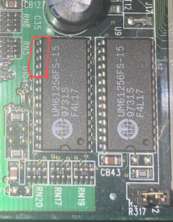

Don´t poke under the chip - too hard. Some solder-balls might lose contact. This green micro-pcb is quite flexible and can easily be bent.
On my (now FUBAR) Jetway J-5HXA the TIO 10 pin goes to an empty resistor position besides one of the L2 SRAMs. If the resistor was populated TIO 10 would have been pulled up, but it never was.

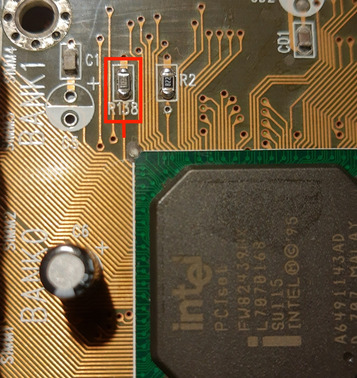

Reply 67 of 240, by CalamityLime
yeah, I was wrong
I took a look around and found some resistors whose legs were small enough. I don't know what pin I was looking at but the balls goes to a resistor right beside the chip.
I thought it was that resistor before but I assumed it would pull up to 5v and I didn't get a connection to 5v from it. Instead it went to the negative leg of a near by cap.
Be Happy, it's only going to get worse.
- Projects
Limes Strange 3D models
USB-2-232
Reply 68 of 240, by CalamityLime
R138 is the resistor in question.
All I have to do is remove that and I have easy access to io10.
While I was at it, I filed away the mask of the traces you pointed out in a previous video. I'm willing to try soldering a wire to them.
Seeing the bit is rework lowed my expectations so who knows, could be fun.
