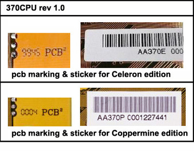

Reply 48 of 78, by PARKE
Grem Five wrote on 2022-06-25, 22:48:
AA370P (marketed as Matrix & Evercool) 370CPU rev 1.0
FCPGA Coppermine / 133 / auto voltage / no voltage clamp
on page 3 I tested last night and have marked Celeron Slotket as I only got a celeron to work on it and not the coppermine cpu on the Dell Board.
There are (at least) two versions of the AA370. The ones with 1999 datemarks on the rear side do typically have a sticker with [AA370E] marking and support Mendocino Celerons. The ones with 2000 datemarks on the rear side do typically have a sticker with [AA370P] marking and support Coppermines.
Does any of this info fit your version ?

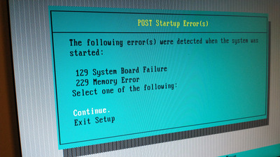

Slotket was definitely the issue with it not powering-on. I found someone who was local that sold me a Shuttle HOT-C003 rev. 3.2 (aka AZZA 370 CPU Card). Now it boots, but the weird issue is that there is no L2 cache being reported in the BIOS. I can boot after getting an error, but it is extremely slow. It seems that the cache is really not working.
I had this same issue with an 850 MHz Slot 1 256KB/100/1.65v (SL43F), but returned the item to the seller thinking it was a faulty CPU.
Any ideas about how should I proceed?

Reply 53 of 78, by Sphere478
rootinit wrote on 2022-06-28, 01:42:
Slotket was definitely the issue with it not powering-on. I found someone who was local that sold me a Shuttle HOT-C003 rev. 3. […]
try a bios update?
btw, I encourage you to track down the difference between those two slockets so we can know what needs to be modded in the future. 😀

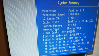

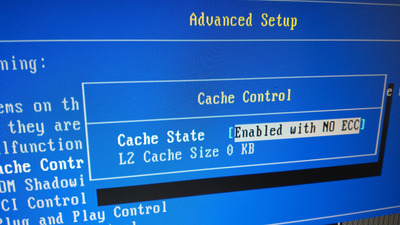

Another weird thing is that I put in a SL4C8, which is also a socket 370 1 GHz PIII, but this one only has a multiplier of 7.5 with a FSB of 133 to achieve this. I thought it'd be reported as a 750MHz in the BIOS (this machine only has 100MHz FSB), but it shows as the full 1 GHz. Maybe the slotket is doing some trickery? Either way, it still has 0KB of L2 cache for some reason. I have another PIII CPU coming in for testing soon: SL4CC 850MHz/256KB/100MHz.
IBM ThinkPad 755Cs (Win 3.11) • IBM ThinkPad 365x (Win 98SE) • IBM ThinkPad TransNote (Win 2k)

Assuming they were ever designed for them, maybe the BIOS detection routines are struggling to identify cpu type / features and are just 'best guessing' instead - 0KB cache might imply it thinks Celeron?? and the 133MHz FSB maybe just parroting what the cpu / sloket combo is reporting?? - what does a program like HWINFO report (also try SPEEDSYS / DOSBENCH if you have them)

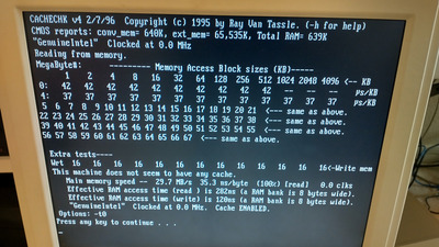

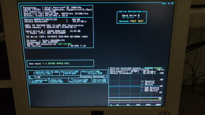

Thanks for checking back with me. Here are what some of these sort of utilities are showing.

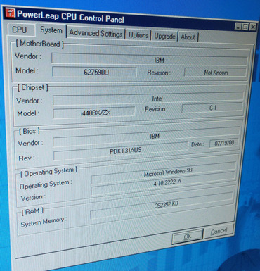

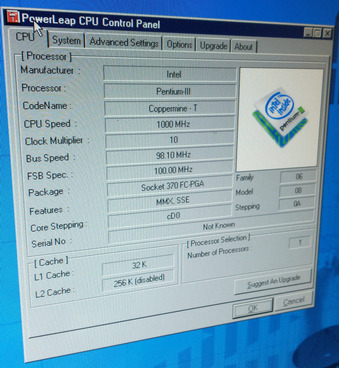

I also installed Powerleap CPU Control in Windows, and saw that it incorrectly identified it as a Coppermine-T (probably because this one shares the same CPUID as some Coppermine-Ts). I tried to force enable the cache in this utility, but it just blue screened, and made it inoperable.
