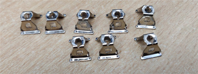

Have a few old Dell cases from the P1 and 2 eras that I'm doing "sleeper" builds in. And by sleeper I mean a P4 based Win98 machine and a third gen Core based XP machine in. I need more of these clip in mobo standoffs. I cannot for the life of me find anything online about just buying the clips. You have two variants of this style of clip, one with the hook as i'm showing and the other that's threaded for a standard mounting screw. I'd much prefer the one threaded for mounting screws. Does anyone know where I can find a a pack? Outside of buying another old system just to salvage the stand offs which is a little pricy and a bit of a waste.
Thanks for any insight you masters of retro can provide!

Could you adapt the hole to take a normal standoff using a nut or something?
Here is the case, you see them square holes? That's what the the standoffs clip into. I'm sure someone with the right skill set could fabricate something to work with ease, and with enough time I bet I could too but due to time and wanting a quality finished product I'd much rather try and get the right clips and be done with it without spending days/weeks trying to figure something out only for it to end up looking armature at best.

I imagine a cage nut with a washer on it to screw in regular standoffs or a stack of washers and a longer screw...
Yeah I was just thinking that. If you google "M3 cage nut", "M3 clip nut" or "6-32 cage nut", "6-32 clip nut" etc then you get some promising results.

Thanks for the replies, found these on FleaBay https://www.ebay.com/itm/302486046153?hash=it … 1sAAOSwttRZuaBg, they call for a 3/8 square hole and the case has 1/4 inch holes as far as I can measure. Should be able to file the "wings" to fit fairly easily then i'll just measure to see where i'm at for stand off height. Ton's of options for different height standoffs. When they get here and I test fit i'll report back in case anyone else finds this thread in the future.

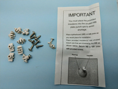

I had a vague recollection of having some of these and had a bit of a hunt around.
Are these suitable?
