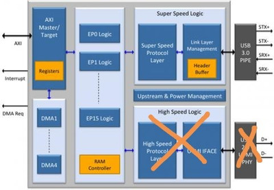

Edit: Okay, one more try..
In the diagram below, there are the function blocks of an USB 3 controller shown.
In Intel's implementation, the "High Speed" block for Legacy USB is missing.
Its task is performed externally by an USB 3 hub (attached to "Super Speed" block).
USB peripherals don't care, but OSes won't see nothing except an XHCI controller.
Because there only is. OHCI/EHCI isn't physically available as a fallback.

Now I get what youre complaining about. Something like Z87 (what Im using right now) can force chipset to switch routing between EHCI and XHCI https://winraid.level1techs.com/t/asrock-z97- … -problems/33161. On never stuff XHCI take care of USB 2.0 using Rate Matching Hub http://beronet.com/wp-content/uploads/d ... 20r1p0.pdf
This is exactly how EHCI took over from OHCI, USB 1.1 handled by Rate Matching Hubs https://www.manualslib.com/manual/407247/Inte … 1.html?page=214

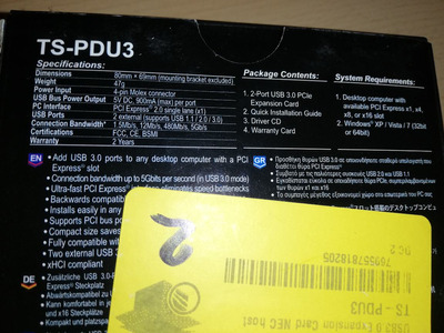

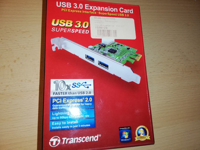

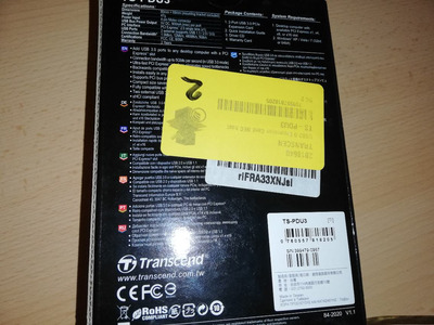

Edit: Good news! Found the box of one of the old USB 3 cards..
It's a Transcend model (TS-PDU3) with official XP support! Photos taken and attached for you guys!

Thanks ! might just buy one or two. It uses Renesas chip from INF of the driver from Transcend....

Just got one NOS made in 2012, only took 3 days to deliver. Found the manuals and drivers earlier and will give it a try this weekend if I have time.
