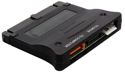

SATA solid state drives are great, I use them in just about everything, but sadly that chipset does not work with them; to use one you'll need to use a SATA to IDE adapter. I use one of these in my KT6oo motherboard, I like them because of the relative neatness, but I don't know that they are any better than any of the other SATA adapters out there.
