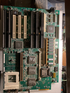

I got this motherboard a while back and have been wanting to get it going.
it won't post though.
wondering if maybe the wrong cache module got installed or maybe the wrong plug on the aux power connector. in any case it has never worked since I have owned it. in this thread I will try to get it working. lemme know if you have any ideas.

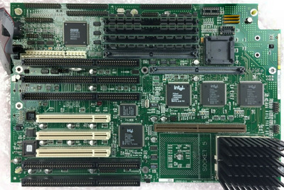

Reply 1 of 77, by ajacocks
It's interesting that there is a second socket silkscreened on the board. I assume that this entry is your board?
https://theretroweb.com/motherboards/s/zeos-coral-max
It's quite a nice second generation P5 board.

Reply 2 of 77, by Sphere478
Not in front of board atm so just used retroweb/UR images. But same board. I posted that link in OP btw. You missed it 😀
Adding the second socket is definitely part of the plan. First step, get it working though.

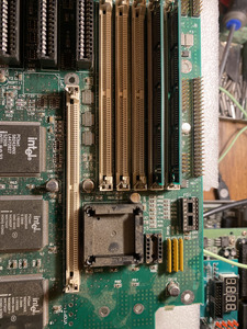

Reply 3 of 77, by dionb
Those sockets in upper right of pic are also interesting - looks like the SCSI controller is optional and you need to populate them for that.
As for not booting, you say:
Obvious first step: try to boot without cache module.
The slot looks like standard COAST, but most (if not all standard) COAST modules are PLB cache, whereas the i430NX can only use asynch cache. If there's a PLB module in there, that would explain a lot...

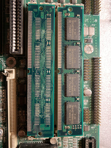

Reply 10 of 77, by Sphere478
Okay, I’m in front of it again.
How’s this cache stick look?
Edit: note the color coded pinout on the extra power plug orange for 3.3v and black for gnd.

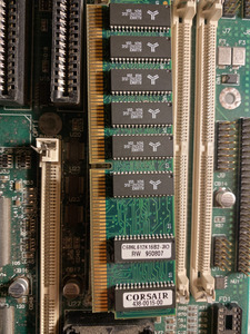

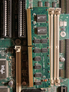

Reply 11 of 77, by Sphere478
This memory okay?

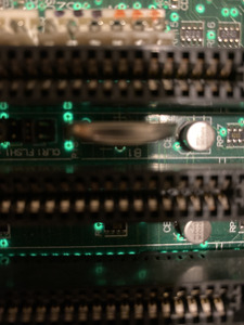

Reply 12 of 77, by Sphere478
Any suggestions for a removable battery clip that will fit?

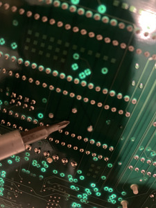

Reply 13 of 77, by Sphere478
I’d also like to get the scsi working eventually. So if anyone knows a card that I can order and rob a chip and crystal from, lemme know.

Reply 15 of 77, by dionb
Sphere478 wrote on 2022-12-02, 03:46:
This memory okay?
Look up the chip codes: tms427809
The '4' suggests Fast Page, which is good. Having a bit of trouble decoding the rest (or finding a data sheet). That '2' might indicate low-voltage 3.3V chips, which isn't good on a 5V board like this. But it might not...
Don't you have two bog-standard 4MB SIMMs with 8 (or 9) 4400 ICs on them? That's the gold standard for FP that anything should work with.
Reply 16 of 77, by snufkin
Memory looks to be 3.3V EDO: https://www.digchip.com/datasheets/parts/data … 427809A-pdf.php
Searching for 'CR2032 vertical battery holder' seems to return various holders that look like they might fit.

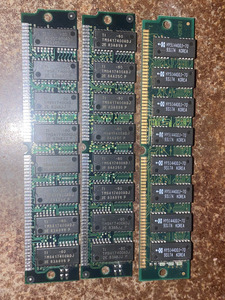

Reply 17 of 77, by Sphere478
dionb wrote on 2022-12-02, 12:30:
Look up the chip codes: tms427809 […]
This memory okay?
1.81 MiB
1584 views
These are the only other possibilities that I own. I’m pretty sure that top one is what you are talking about

Reply 19 of 77, by snufkin
Sphere478 wrote on 2022-12-02, 16:43:
Looks like the memory you've ordered is suitably overkill. For reference, the sticks in that photo look like a couple of 4MB and a 16MB, I think they're all 5V FPM (417400 datasheet calls it Enhanced Page Mode, which from a quick skim looks like FPM). The pair of 4MB are probably useful for testing. Just noticed that the manual from that RetroWeb link in the first post says the maximum RAM is 384MB. So it's possible that board doesn't support 128MB sticks and might just see them as 64MB.
