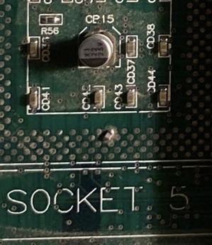

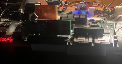

Today’s project was the socket.
You may have noticed that my socket (primary) was in bad shape.
I didn’t want to go through the trouble to replace it but I did take it apart and replaced the lever and slider. Which is good enough for now.
I also installed the second socket. Which is kinda a pain. Bur I have practice. It took two hours I think? Anyway. It still works and continues to act buggy as hell and be very picky about cpus
But still working is a win for now.
Have been unable to confirm function of second cpu suspect no dual is ocuring.
That’s a problem for another day.

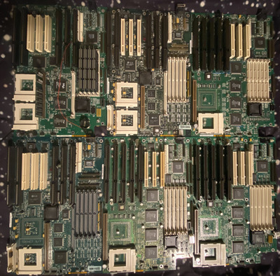

getting these soon.
Looky, one has the scsi populated!

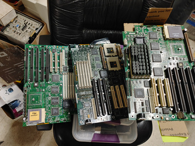

Got some more zēos motherboards today unfortunately not in the best of shape. But might play with the vlsi dual at some point. Can anyone tell me anything about the vlsi chipset? Is it rebranded intel?
