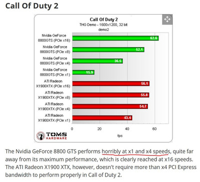

Same goes for PCI x4, in 2004 it seems on par with (real) AGP 8x, in 2007 not so much.

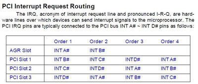

Some time ago, i have benchmarked the "AGR" slot in my athlon system (board: MSI MS-7135 , nForce4-4X, PCIe x16 and 'AGR (Advance Graphics Riser) slot' )
I don't know why you are talking in terms of: "a hack of AGP on PCIE"
First, in the manual there's a list of compatible VGA cards for AGR slot.
Second, there is an IRQ table, showing AGR is sharing interrupt.
To me it looks more like fake AGP on PCI,

VIA provide true AGP in tandem with somewhat gimped PCIe 4x. PCIe bandwidth is not an issue for most scenarios with video cards that are realistically usable on such setup.
Yes, but some have AGI x8 and a list of supported cards (along AGI Express), some don't even mention AGI yet have a list of GPUs, some have none like that ASUS one... I mean, some state AGIx8, some AGPx8, for the same chipset... I'm worried more about AGP support here, PCIe x4 will gimp GF7000 series and on.

Reply 18 of 43, by 2mg
The Serpent Rider wrote on 2022-12-04, 02:06:
This:
95.33 KiB
1579 views
PCI 2007
"The two 3D games we used - Quake 4 and Call of Duty 2 - certainly cannot be called demanding these days, yet they benefit somewhat from faster link speeds. The professional benchmark SPECviewperf 9.03 was the real eye-opener, as it categorically disqualifies PCI Express link speeds below x16."
Yes, in Quake 4 there isn't such a huge dropoff, but any other chart shows x4 cuts the GPU almost in half.
From your other article: https://www.techpowerup.com/review/intel-ivy- … -scaling/8.html
The way I see it, there are more charts that show PCI x4 drops than there are charts that show near x16 performance.
No.

Reply 19 of 43, by The Serpent Rider
2mg wrote:
This:
That actually proves my point:
8800GTS 320mb (not enougb VRAM) = bad performance.
X1900XTX 512mb (enough VRAM) = good performance.
What do you think - real AGP on PT880 Pro/Ultra
Just read VIA chipset specifications. My opinion can't change them.
Perfectly suitable performance - 100fps+. And that's with cards which are much more powerful to what realistically can be used on VIA motherboard, with much more weaker CPU.
