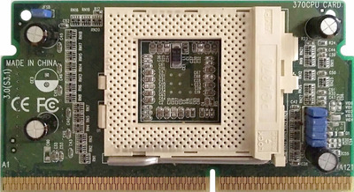

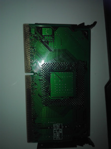

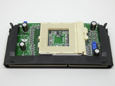

I just got s370 to slot1 adapter without manual and I have no idea how to set it up. Pics of adapter in attachement.
    185.09 KiB
    298 views

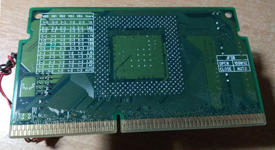

For setting vcore 😀 setting will vary by cpu.
🤔looks like it doesn’t make the voltage its self, but rather the jumpers send the request to the mobo.
Sphere's PCB projects.
Reply 4 of 11, by PARKE
Ok, in your case the print is absent. But this is the QDI 3.0 (S3.1) slotket and the settings in the photo above should work.
322.63 KiB
229 views
Reply 5 of 11, by haker120
They do however P3 doesn't work and only Celeron I own is 1.1GHz and I'm not sure that will work. And before I'll confuse anyone, I did set 1.8V as this is the minimum my board accepts. 😀 Works with my other modified slocket1 at 1.8V.
