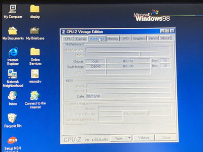

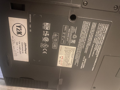

So my friend has this laptop.
133mhz
TCP package pentium mobile 133mhz
1.91 MiB
786 views
16 mb of ram.
fun stuff.
But We couldn’t leave well enough alone.

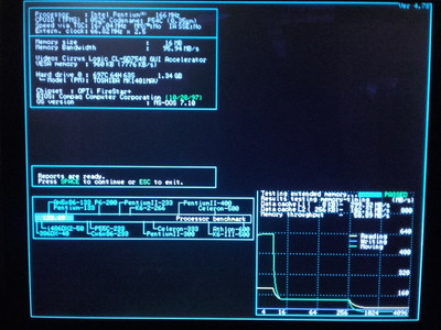

We proceeded to bust out the volt meter and attempt to find the BF pins.
We were able to locate them and proceeded to try a variety of combos.
1.92 MiB
786 views

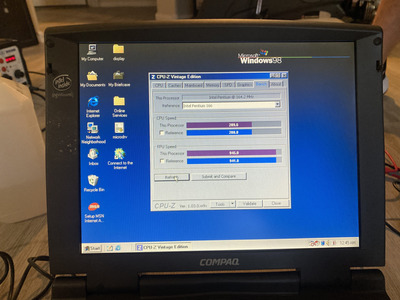

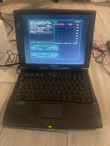

Eventually discovering shorting them both led to a bus factor of 2.5x as a maximum settable. 166mhz

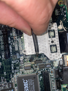

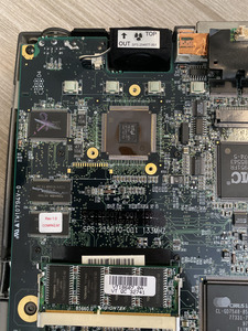

Shown above are the two bf resistor jumper pads. Both jumppered for 166mhz one by a 0 ohm and one with a solder bridge
1.62 MiB
786 views
1.68 MiB
786 views
1.7 MiB
786 views
During my testing I discovered that the BF pins in open are floating. Which means that one more try could be made to attempt to get to 3x which should be the maximum settable bus factor of p54c
We don’t have the appropriate resistors on hand though. However we did identify a good vcc3 source at the tantalum near by.
The ram ended up being EDO dimms. We only had a 16mb stick on hand. Sd sticks didn’t work.
Curious if 128mb edo dimms will work. We will have to see if he is interested in ordering them.

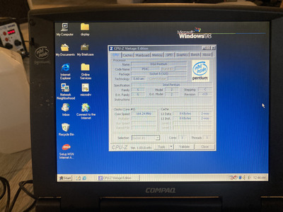

But successful upgrade today. 16 more mb for a total of 32mb and 33 more mhz for a total of 166mhz.

We pulled it apart again and tried adding pull up resistors. But something seems to have happened that locked up the bios or something. It actually gave us quite a scare and we thought we broke it.
Turns out holding the sliding switch and pushing the blue power button a few times in a row did a reset or something and it fired up after putting it back to two shorted bf jumpers.
166 mhz.
I kinda think that maybe had we known it was going to do that that maybe one of the pull up settings maybe worked, but we decided to take the win and run with it. Put it back together and called it a day at 166mhz.

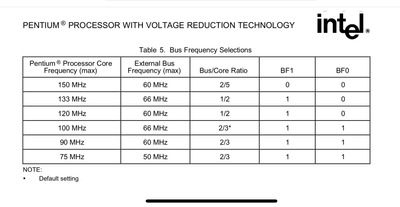

Reply 7 of 12, by snufkin
Not sure. I think the table ought to be:
BF1 BF0 (pins 185 and 186)
0 1 x3
0 0 x2.5
1 0 x2
1 1 x1.5 (default)
but there's a note here: http://www.cpu-zone.com/Pentium/Pentium%20pro … ecification.pdf about a correction to the MMX datasheet regarding the x3 multiplier that
This bus ratio is currently not supported in mobile Pentium ® processor products.
Ah, just found what I think is the right datasheet: https://www.ardent-tool.com/CPU/docs/Intel/Pe … /242557-005.pdf and the BF table there just doesn't list 01 as an option. So at least according to the datasheet then it won't do x3.
Reply 8 of 12, by Sphere478
So according to that we are indeed at the maximum frequency unless we can overclock the front side
I was trying to remember at what frequency the first generation socket 5 pentium CPUs ended
I guess it’s 2.5 X because I remember that they had a refresh of some sort that allowed them to get to 200 but I had thought that it ended at 133 and the new generation was 166 and 200 therefore I was thinking that this was of the new generation because it supported 166 but it appears to not be. Maybe there is overlap in any case it appears that the CPU only supports up to 166 MHz 2.5 X unless overclock in the front side
